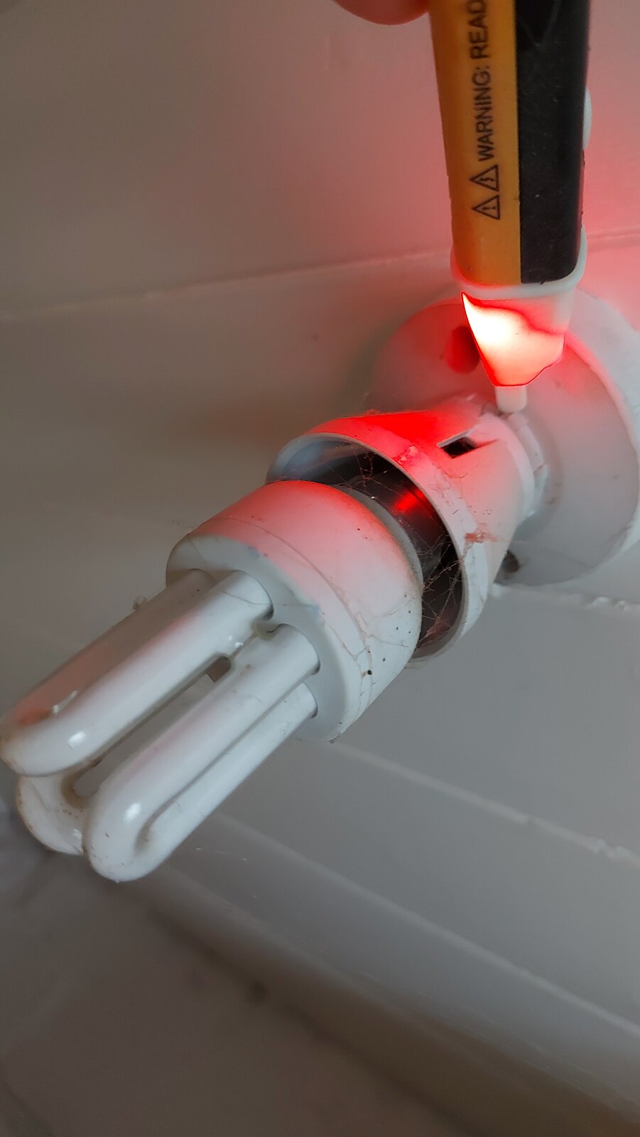

Hi folks,
I have a ceiling light in my pantry, but it stopped working a few years ago after I had an electrician round to do some work in my adjoining kitchen.
I kept meaning to get him back, but then never got round to it and years went by. I assume something he did has caused the light not to work, but I guess it could be coincidence.
Anyway, I tried the bulb in another socket, and that works fine, so it's not the bulb.

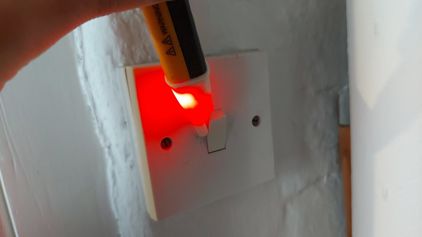

I then bought a circuit tester gadget - and that lights up like a Christmas tree when placed near the light socket and the switch (see pics) so there's power there.
Sooooo, any ideas what I can do next? Could it be a faulty switch, or faulty socket maybe?
Any advice gratefully received!

I will guess no neutral, we call it a circuit, as it goes both in and out, it needs both lives that line and neutral to work, you clearly have line so likely neutral missing.

likely where electrician was working a neutral has been left disconnected, likely nothing to do with the light which is not working.
I would check (with the power off) that the contacts are good and springy.

Based on that, logic would suggest the light was somehow connected to the sockets, and a cable was left disconnected or a wire broken off.
It could 100 different things in reality.
