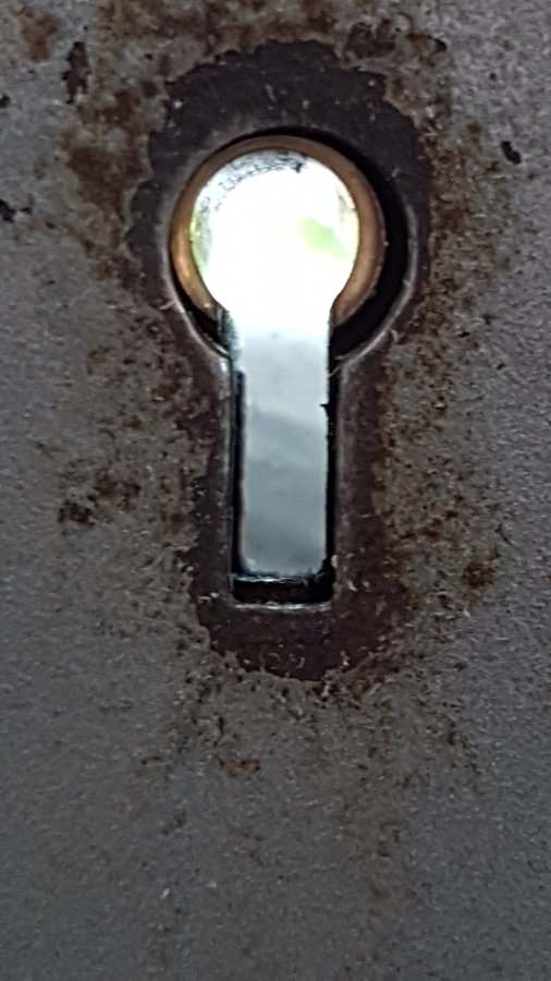

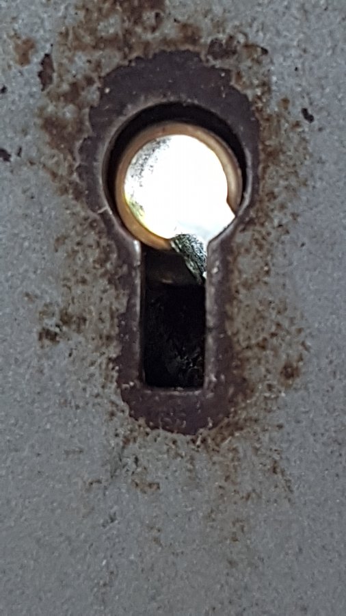

However, this lock incorporates a curtain/bolt thrower which is a great security feature as far as anti-pick, but has a small downside. Problem is that if one of the occupants tries to open the door with the wrong key (probably internal lock key or Yale key depending on how long they've been down the pub) it's possible for the curtain to move round and block the keyway. Yes it's a piece of P*** to reset, but there you go.

Yeah, your're right another one would need to comply and if it's a lever/detainer lock, it would most probably also have a curtain as with the 3R35 and they'd be back at square one. I dont know if there are any high security locks without a curtain? Is there a cylinder lock for instance, that's big and very secure like the 3R35? And I was actually wondering if anyone could see any flaws in my plan to tell them to blow it out of their blowhole.
One thing I don't get though is how they manage to remove the key albeit the wrong key but still leave the curtain spun so they can't get the correct key in?
the Chubb detainer range is built to quite close tolerances, and will not accommodate being "a bit out".
I've known someone leave the curtain slightly out of alignment so a key won't go in. I don't know how they managed it. Perhaps jiggled the key slightly when removing it.
Once you recognise the problem it is quite easy to poke the curtain back into position.
I have been using 3R35 for many years and in several houses. They are splendid. I like to dismantle and clean mine every 20 years or so.
I know, it's hard to believe people manage to do it. As I said this happened once to the old Chubb and once with this Union one, but it happens so rarely. I've actually tried to make it happen deliberately it as a test with the wrong key and it takes some doing. It might be when you have a key with a profile where the lands/cuts on the bit, form a sort of "E" shape and the end land (hope I got the terminology right) hooks onto the curtain without either going into or sitting square onto the keyway, mainly because the shaft is too small a diameter and thus can be removed. It might also be when they pull a incorrect key out. Either way I've found other people online that have had this issue, even though the phenomenon is as rare as rocking horse ****. Attached are pics of the keyway in both states.

Sorry Crank, maybe I didn't explain properly, it isn't caused by a tired spring (yes it is sprung loaded) it's the expected behaviour of the model. The lock this happened on is brand new. Union (ASSA ABLOY) as they are now, explain that the curtain is for nati-pick reasons, but they don't make a point of saying the curtain is designed deliberately to shut the keyway down as an additional self defence feature (although I'm glad it does myself as it's one more thing to keep the Ar**H**** out : -)
I have only had it happen once. I wasn't there. the builders who had locked up the night before said they couldn't unlock it in the morning.
Another trade with more sense jiggled it back with a small screwdriver.
I don't think it has ever happened before.
The spring is not a return, it is a detent. If you push the curtain round, the spring will not put it back.
"only had it happen once" Thanks for that John, I'm starting see that this seems to be a rare to occurence. John, Crank, with regard to the terms "sprung loaded", "return" and "detent" as John remarked, I'm pretty sure detent is the correct term, cheers. Funny that you said it was your builders that caused it, in my case it was someone else's contractor the first time it happened, years ago.
I've seen it happen before years ago but only the once and i posted here about it, got called out to gain entry into the side door of a garage, customer said the key wouldnt go in the lock anymore but was fine the day before, so I got there and knelt down and looked through the handle and saw the curtain had spun around, easy fix with a thin screwdriver and 30 secs and I was done, customer had gone to make me a coffee so I took the trouble of removing the handles and lock, it was a BS ERA fortress sashlock, stripped the lid off it to inspect and see why it should spin, the spring was there and working and like John said it's a detent not return, greased it all up, had my coffee and a quick chat to explain what had happened and the lock was fine and didn't need changing and I was on my way, didn't charge anything as all I'd done was flick the curtain and greased the internals.
