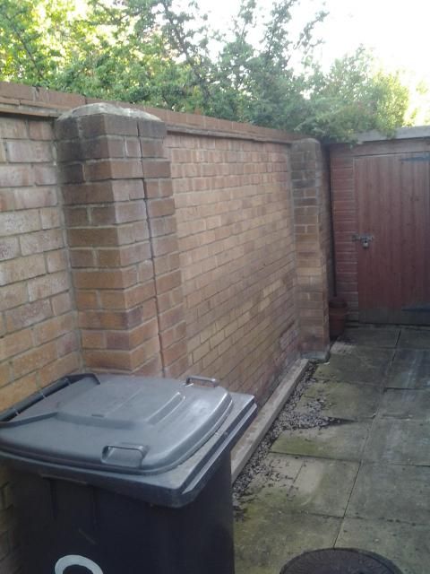

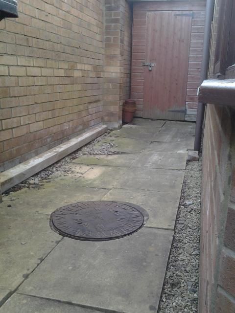

Anyway, down one side of the house/conservatory, I've noticed that the paving slabs have sunked a little (perhaps about 2" at the 'deepest' point).
See photo's below. The wall on the left is the garden wall, on the other side is the pavement & public road. The wall on the right is the conservatory, and the side of the house.

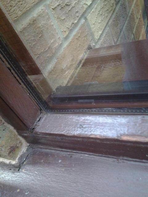

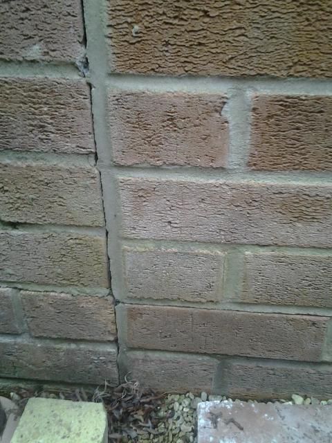

Noticing this had been niggling at me a little, so today I cleared away all the rubbish that had been there for a closer looked. Quite concerned to find that, the conservatory has clearly dropped perhaps 4-5mm, as is evident by the photo's below....

above, notice the window cill inside and out
above, best angle I can get of the 'drop'. Note that by lifting some of the loose slabs, I can see that some ground has subsided beneath the slabs.
Suspecting that perhaps one of the drain pipes in the ground has collapsed, I've had a look under the drain cover you can see in the photos. There is no obvious damage (not even cracking) in there. Water is still flowing out from the main/kitchen pipe. But I haven't yet tested flow from the gutter downpipe you can see running down the wall.

4/. Your Surveyor could claim that he could not see the paving slabs because of the debris stored out there, BUT? there are clear indications in your posted photos that there is a large difference in the bed joints between the main house wall and the extension, any "competent" Surveyor should have picked up on this.

Just lift them up and put some more bedding material underneath, then relay them. Your drain hasn't collapsed. It's plastic and only a few years old.
The conservatory settling is what almost all house extensions do, and can be ignored if the movement has stopped.
