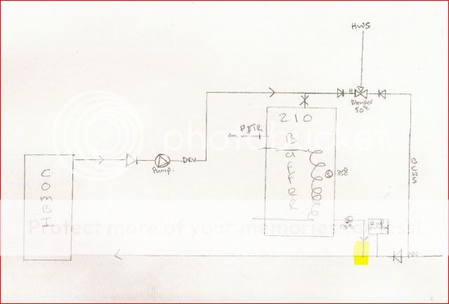

Right cant find my wier guage (spelling) and cant be bothered timing it right now.
Anywhoo i have a rough sketch of how i was originally piping it.
Tried and tested and works... Thoughts?
Yellow are could be blended to ensure a min amount of cold was passed to the combi
Is the buffer temp maintained by the combi?
Is the coil for solar?
Yes mate, in the future anyways
Combi will replenish the buffer when no hot water is demanded.
When the lower stat gets above 50deg, it turns the pump off. When the middle stat drops below 50 it turns it back on and cycles the water back round the buffer.
Need to figure how to make solar as efficient as poss without losing flow rate.
You can't heat this cyl from the combi like this and have solar. You need to choose which you want. There is no point in setting up a DHW buffer unless your main can support a high flowrate.
I will use a solar buffer and mt design then when it comes to it as somwone mentioned earlier. Would like to have a look at a diagram if there is one.
What type of flow rates are you anticipating? We have at least 20lpm plus

Thanks for the link mate appreciated. Think im gonna bin the primary thermal store idea as i dont want to lose my flow rate etc. I think i will end up fitting a secondary thermal solar store and use that to fee the coil of my HW buffer as a later date. Anyone have a schematic/working diagram of how that would work?
