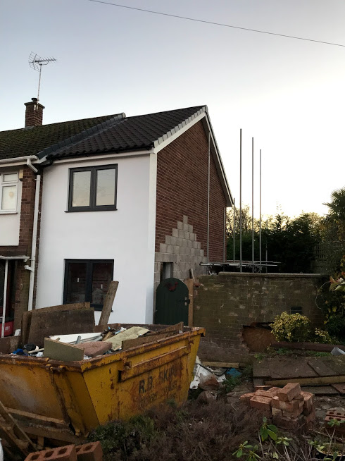

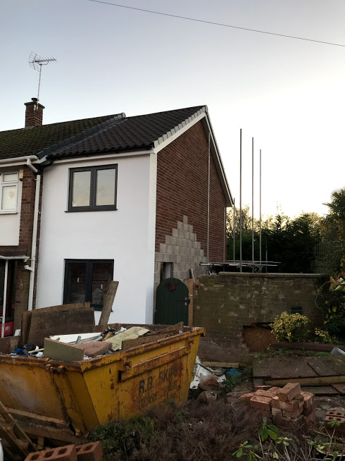

Skips and grabs are a massive cost..... I only had a single grab for my foundation spoil. £150. I have a no skip policy as I’m a skinflint and recon I’d have done 7 builders skips at £200 a pop. Luckily with my trailer and the tip 5 minutes away, time and effort is all it cost. They know me well. By name.
there was a lot of demolition of old outhouses/garage/full of stuff for mine which was all builders skips at 170 each
the rest was 3x 16 ton grabs at 170-180 ish a go for the muckaway for the foundations, which there were a lot of as included a garage and single storey kitchen extension not built yet
