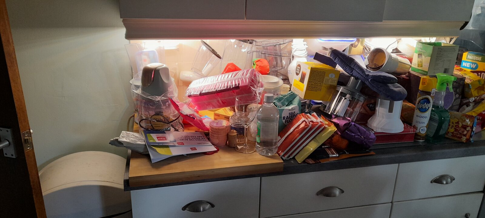

Back to the subject of the thread, we all like to make the kitchen look good, and I have to admit my under counter lights are a bit OTT.
I fitted colour changing lights, god knows why, as can't access the counter anyway. I hope you have more luck than me.

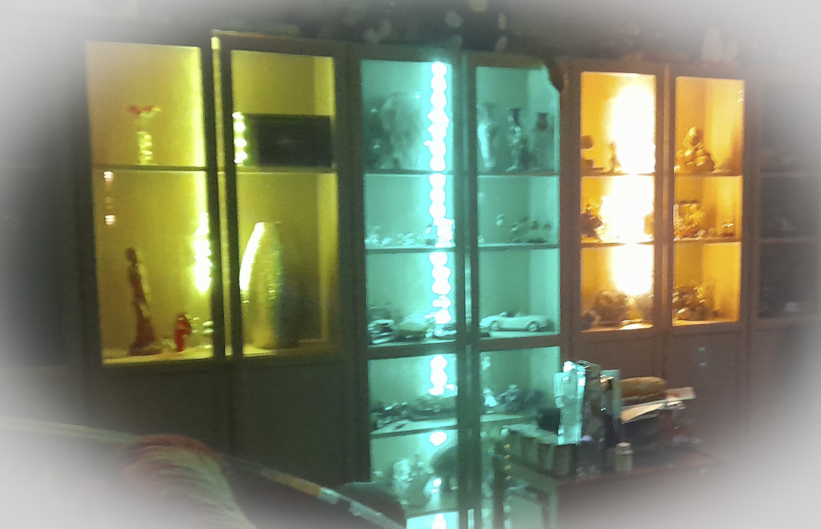

But same lights in another location shows what they can do,
