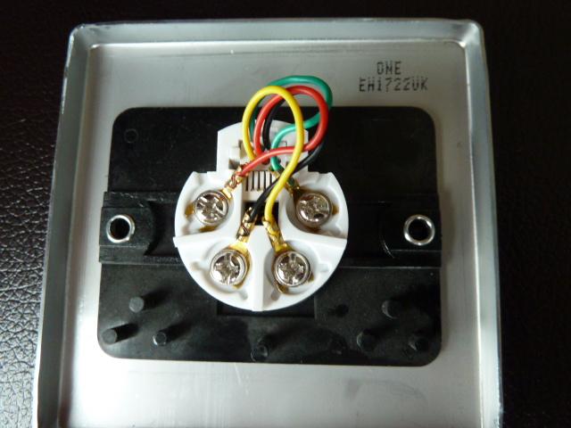

I am running a cat5e cable from a filtered faceplate to an RJ11 socket for my modem/router. The filtered faceplate has its own dedicated connections for this purpose (marked A and B in the picture).
I do not understand how to connect the RJ11 end as no instructions came with it.
Could somebody advise how to wire these two up??
Which wires do I connect to A and B on the filtered faceplate and where do they go on the back of the RJ11....??
I see there are two spare holes up the top of the RJ11 where the four coloured wires go in, are they the pace and if so which wire from A nd B goes in which one???

Do you know which pins in the RJ11 plug are used to connect to the (I suppose modem)
If you do, which ever of those pins marry up with the appropriate colour of wire on the back of the RJ11 socket are the ones to use.
Simply connect from A +B to those colours.
To connect to the terminals on the faceplate you will need a Krone tool and to connect to the RJ 11 socket terminals just slacken the screws and wrap the cable underneath and retighten
connect A and B to the center pins of the RJ11, it shouldn't matter which way round.

So at the Faceplate end, I should connect one set of the twisted pair in the cable to A and B
The RJ11 has two rows of three connections,
Top row as follows from left to right;
Empty
Green
Black
Bottom row from left to right
Yellow
Red
Empty
So you think i should connect the other end of the twisted pair to the green and red??
connect the faceplate A+B to green and red ( I think from looking at the pic and your description) if you have a test meter can you check which of the coloured wires goes to the middle two?
The RJ 11 doesnt have two rows of three it has one row of six but the coloured wires from the screww terminals enter through the back of the socket in a staggered fashion just to make it easier to build
If the modular jack is wired to normal standards, as it appears to be from the picture, then green & red are pair 1, which is what you need for an RJ-11 configuration.
Use the first (white/blue) pair in your cable. Polarity won't actually matter for any modern DSL modem, but to follow standards:
A - White/blue - Green
B - Blue/White - Red
