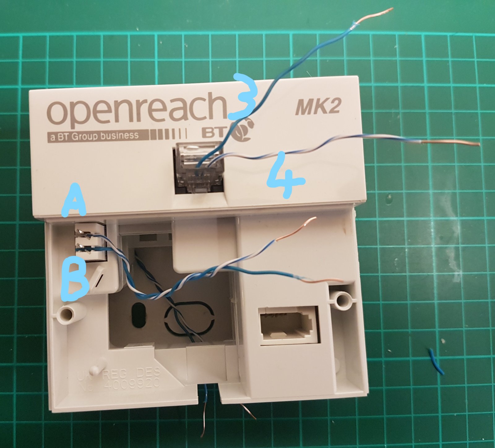

I have a BT master socket with broadband face plate. However I need the router slightly further away.
I would therefore like to install an rj11 faceplate where I want the router. And connect it to the designed AB connections dedicated for this.
How do I wire it up? I know I use the center 2 connections on the rj11. But which way round?
A goes to 3.
B goes to 4.
I don't think the polarity matters nowadays, there no guarantee that your incoming line is the correct polarity in the first place!!
edited, because I had it backwards!

@AndyPRK , sorry, I had them backwards. I have edited the reply earlier.
It had been bugging me as to whether I had remembered it correctly, so I checked earlier with a Mk2 faceplate and A is definitely 3 for an RJ11. They show continuity, as does B and 4 of course.
I was confused because the colour code changes from BT's A & B colours, to the CAT5e style 'swapping the centre pins over'!
