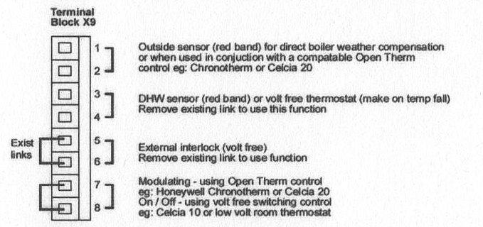

I'm not sure that it is an Opentherm related query or not. I've scanned the section of the Avanta manual that shows the connections for terminal block X9 and copied it below. This makes reference to the 'outside sensor' and an option to have a 'DHW sensor'. The reference to 'red band' I assume relates to accuracy.
Are these sensors both the same sensor and/or what is the correct part no? Obviously the outside sensor will be in a box for outside and the inside sensor needs to be buried under the insulation on the hot water tank. But I assume that they are both NTC thermistors. I just tried ringing Remeha, but unfortunately they are closed until Monday.
You can find the part numbers in the Layout/Wiring guide (pg 3), and they can be purchased at BHL. Naturally, they are exorbitantly priced for the same reason a dog can lick its balls.

I now have a new Avanta 18S that since it's installation I've been using with a CM927. Earlier this week I finally received a iSense RF from Holland and I've spent a few nights this week temporarily hooking it up and seeing what it does. A quick summary:
It controls the CH in either room thermostat or WC mode and appears to work OK doing this.
It doesn't however control the HW. Whatever the settings, time, etc on the iSense a link across pins 3 and 4 of X9 (cyl stat) causes the HW heating to trigger. It seems that a time clock is still required for HW to keep it off when not required. The only thing that does happen is that a little HW symbol appears on the iSense when the boiler is in HW mode.
This afternoon I bought another outside WC sensor and put it across pins 3 and 4 of X9 as I guessed that the thermistor inside a real HW sensor would be the same (the WC sensor is off the shelf and a lot cheaper). It was and this gave a temperature reading for the HW and I could see this both on the boiler and the iSense. BUT the boiler doesn't do anything when the temperature rises. In HW mode the manual indicates that the sensor should cut the HW at the preset temperature, but this doesn't happen.
In summary the iSense RF works ok for CH, but not HW. With or without the iSense a HW thermistor gives a reading, but the boiler doesn't act on it. So for HW an on/off cylinder stat is still required.
