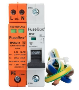

So it still takes up 2 units of space.
There are many manufacturers who supply an MCB to fit with their SPDs.
I thought it tother way round Eric. The early ones I saw said must be used with an MCB and often supplied one as part of the kit. Later models by some manufacturers stated you could use them directly without a MCB. I might have viewed them in reverse history order though but I am not aware of it
I am puzzled.
If an SPD requires an MCB, does that mean that a separate SPD is needed for every circuit.
nope. an MCB fed from the CU Mainswitch then to the SPD will ensure all other MCB circuits in the Consumer unit are protected unless the SPD circuit MCB is tripped methinks
I am puzzled.
Thank heavens for that, at last someone else is having the same thoughts as me.
I see absolutely no point in in providing a MCB to supply a SPD.
I doubt the silly arrangement will protect very much. The impedance of the wiring will render the SPD almost useless against impulses.
Well, very near adjacent circuits in the CU perhaps, as you get away from the CU depending upon the wavelength then you need another apparently say a DB feeding a DB feeding a DB situation you would need one in each DB is the way I understand it

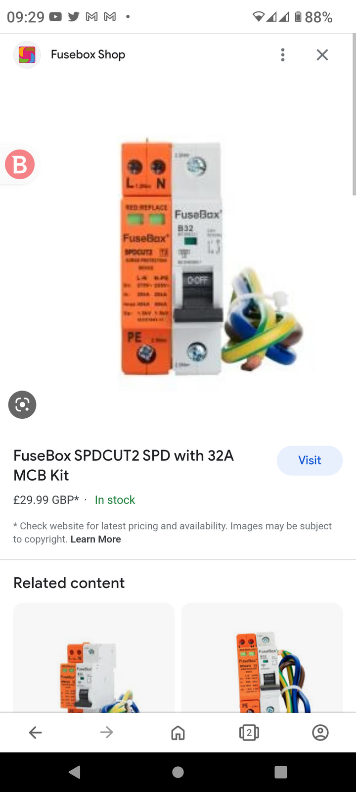

...but, the one pictured comes with a 32A MCB; how can that cover multiple circuits?
