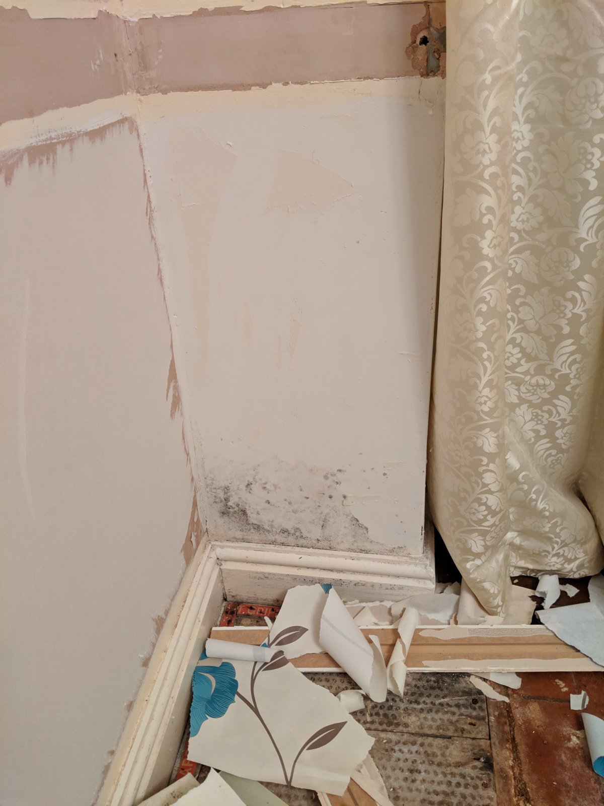

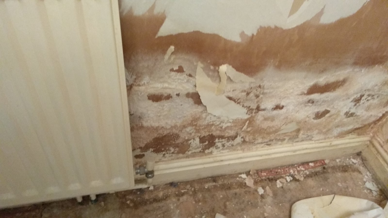

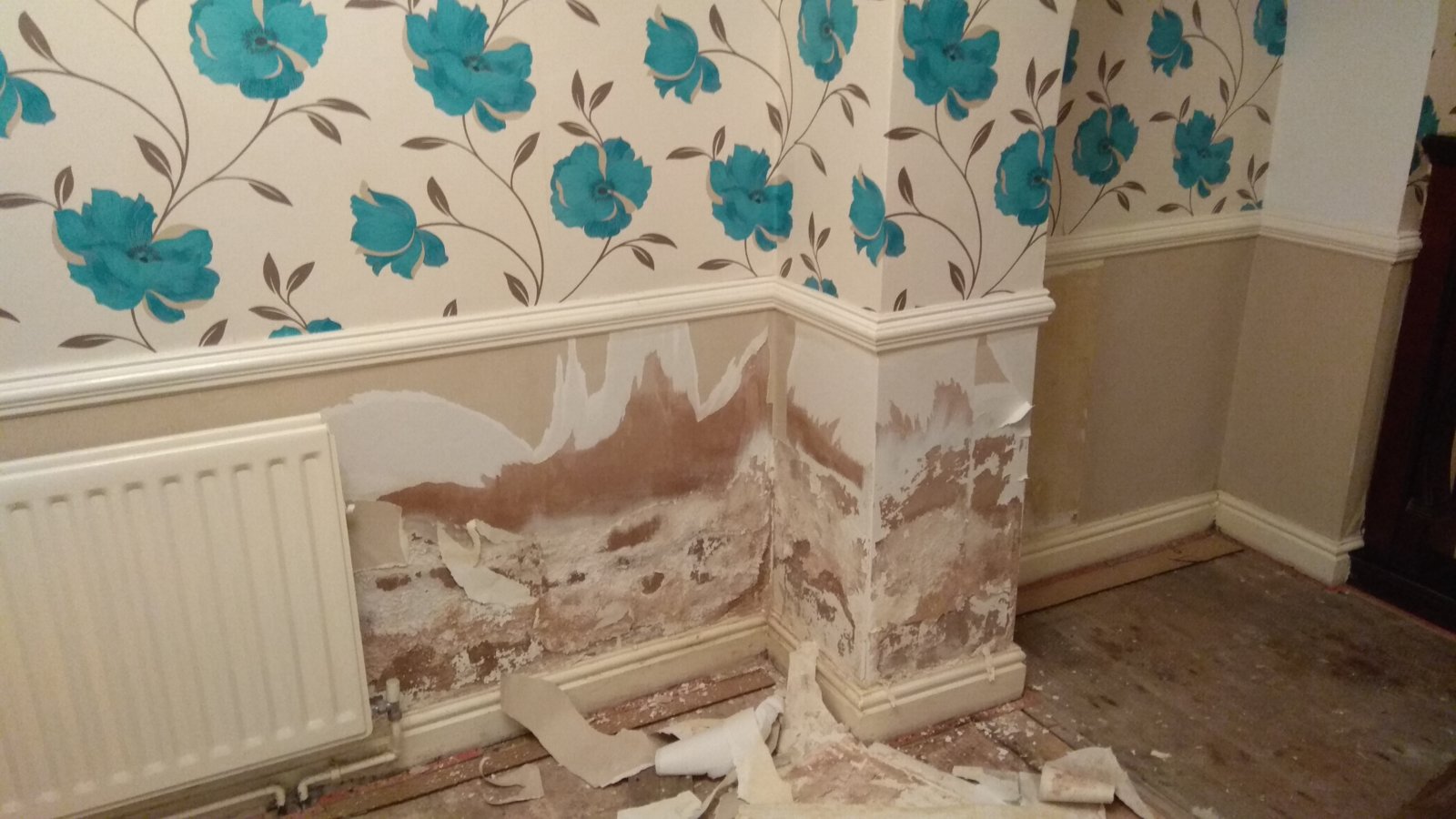

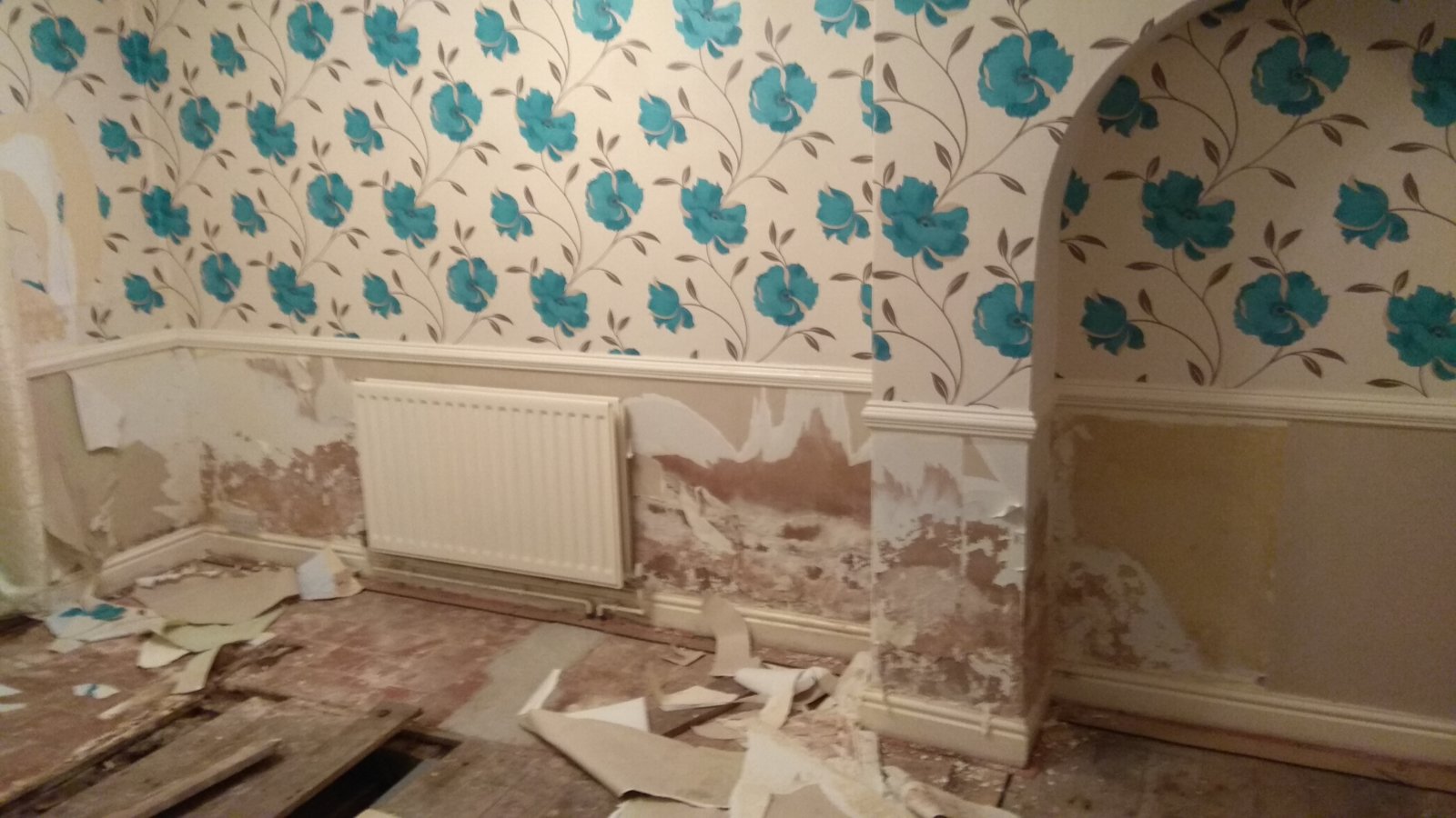

Thanks guys. looks like your suggestions were right and the leak seems to be originating from the centre of the wall (probably the radiator). I re-pressurised the central heating system today and the rad in question was turned off. So I have opened the valves to ensure water is flowing to it. Once I took the paper off near the rad, that part seems the wettest on wall, hence possibly the source. The pipes seem to have green corrosion on them too. Going to wait a day, I guess to see if the pressure drops again and the area around it gets wet or not.

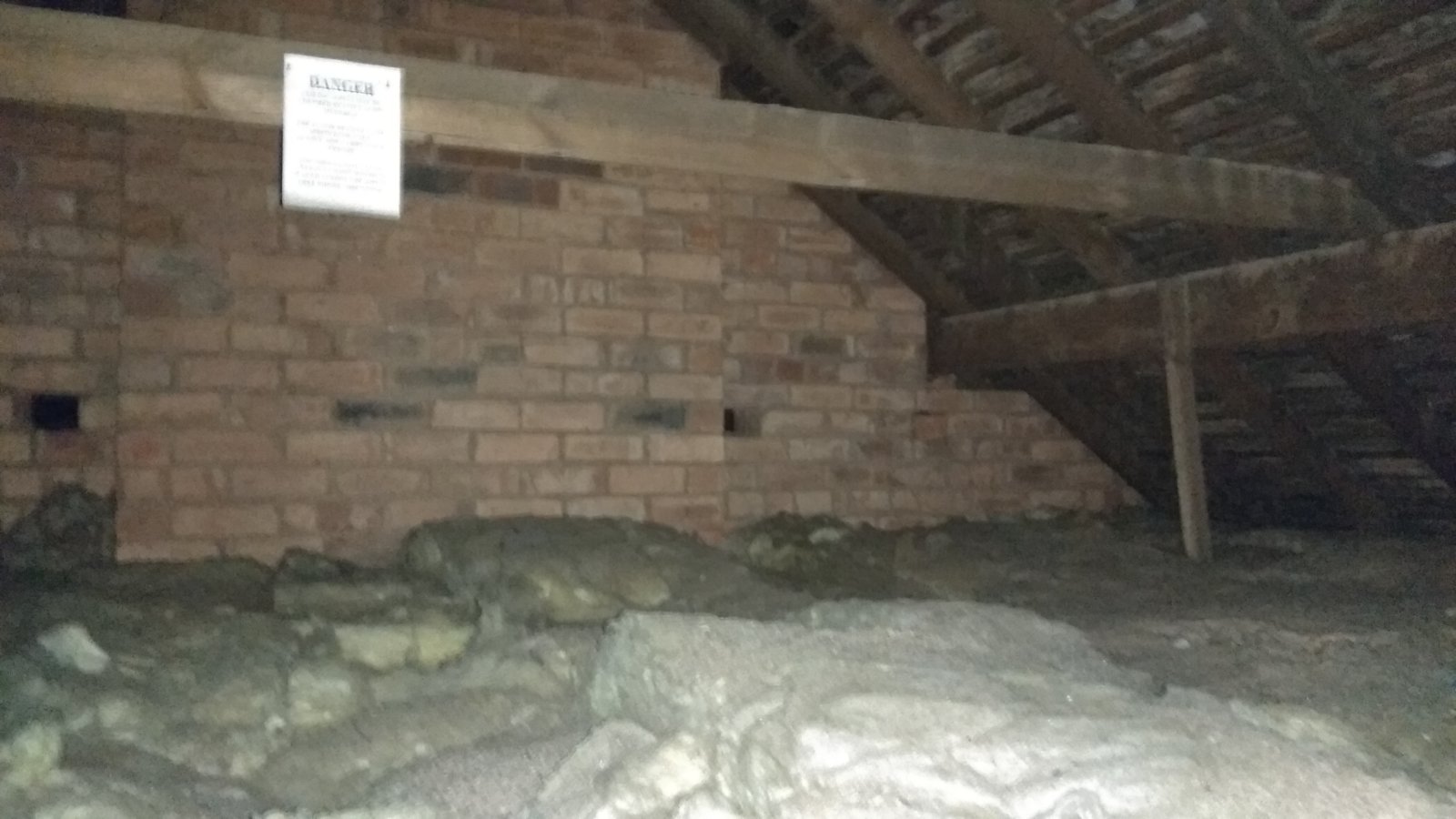

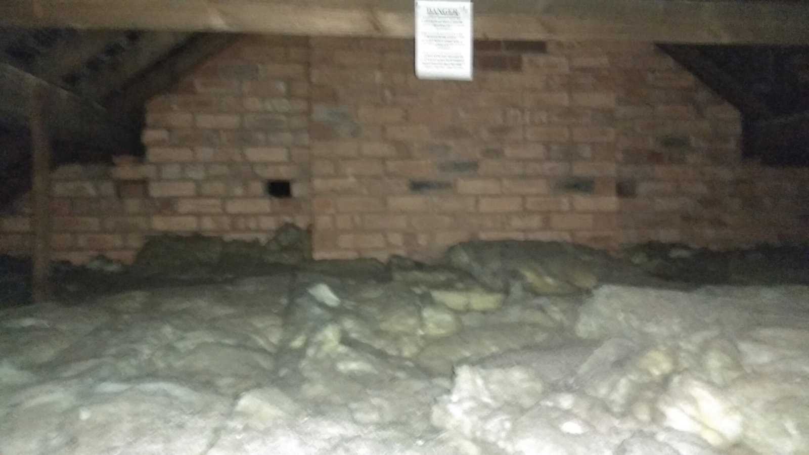

No signs of any plumbing in the loft. here is some fresh pictures I took today.

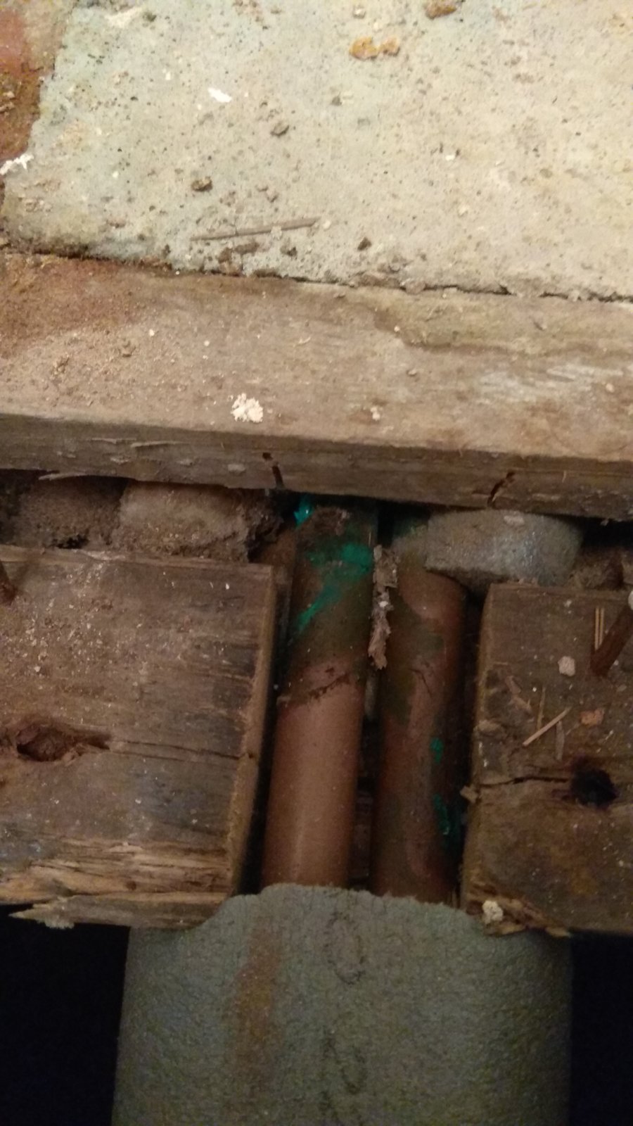

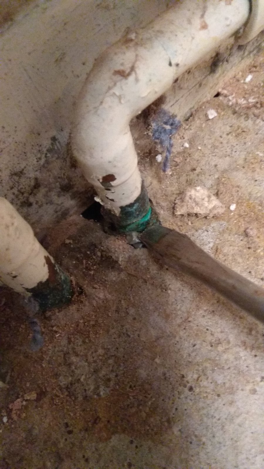

your copper flow an return pipes have been installed under pressure, they should have been installed deeper an sheathed or ducted.
all ccopper turns green if buried.
maybe your pipes are insulated under the concrete patch?
first thing, open up the obvious line of fresh lookin concrete patching that goes from suspended floor to radiator.
an then look for leaks or rising ground water.
youve got damp signs, about 9 or 10ft away from thr rad, on the chimney brest .long way from any possible rad pipe leak?
thers lots of signs of damp in the floor an the wall -
an no sign of a membrane under the solid floor?
i think you should dig out all the solid tiled area an replace all rottin floorin with a full suspended floor.
the transition floor plate area from kit to din room will need lookin at.
install 9" x 6" air bricks for through ventilation.
temp remove the rad.
an then hack off all plaster up to wainscot rail height as far as chimney breast.
remove an check all skirting for rot.
OP, stay out of that loft - no need for you to be up ther an you could easy get hurt.

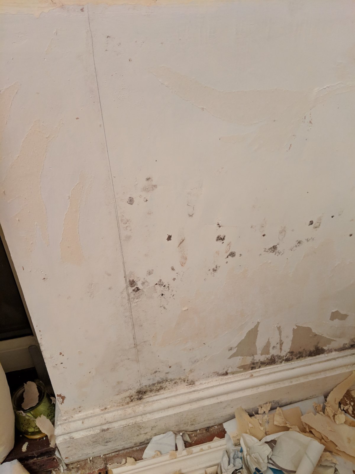

Thanks guys for all your help. Hopefully the concrete floor is getting replaced in the next few days. I just have a couple of more questions, if someone can help.

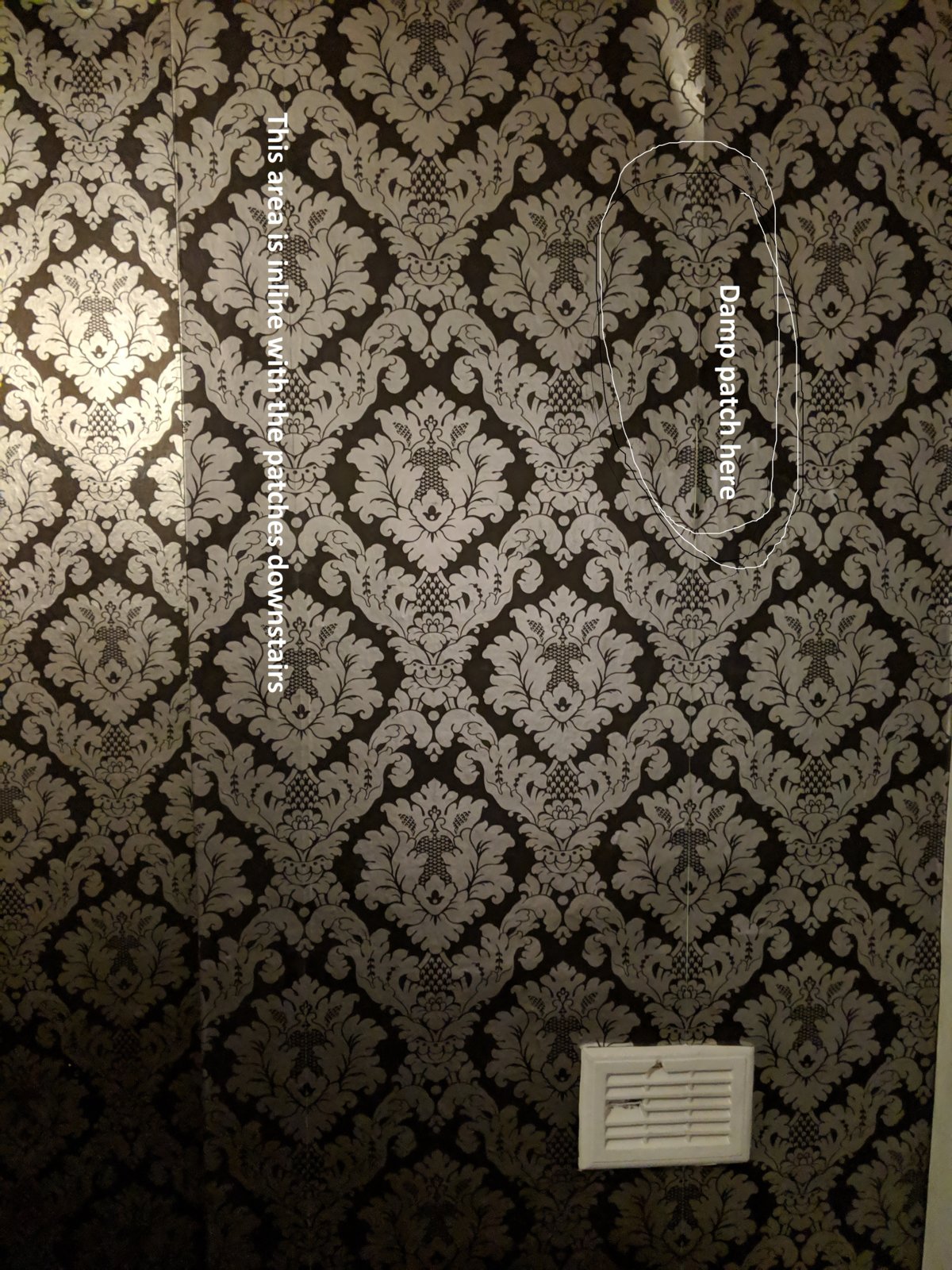

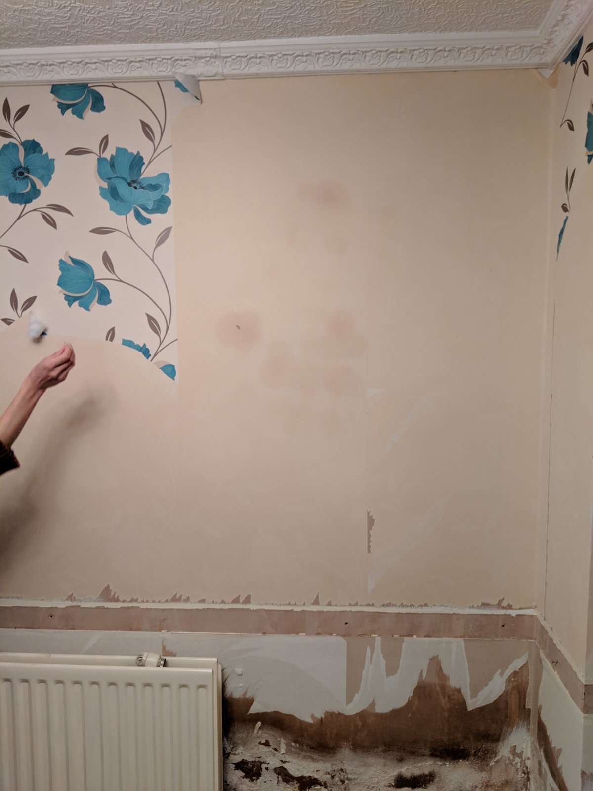

1. While taking the paper off from the damp area, I have noticed a few damp patches much higher up from the floor level. I have also noticed some damp patches in the wall upstairs (inline with these patches)
The house has had cavity wall insulation done (if that makes a difference).

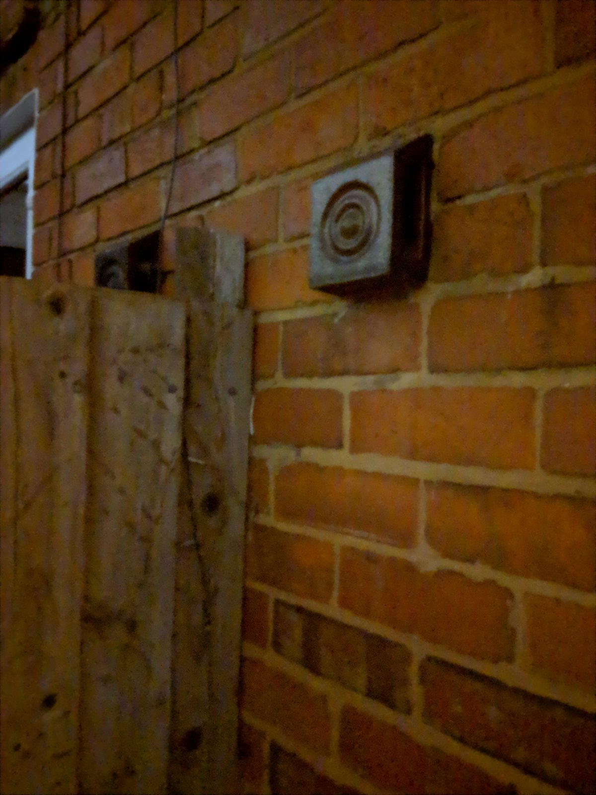

2. Do these look like signs of condensation and a separate issue. The downstairs lounge seems air tights. There are no vents on the windows or patio doors and it seems a vent has boon blocked off. (Please see the picture attached.)
Is this some sort of a vent that should be open on the inside of the house?
The white vent in pic2 (last post) to me says boarded over fireplace? Is the chimney capped and in good condition. It may be a separate issue though, was the house empty for a while?
Yeah the chimney had been boarded over. But the vent is in bedroom. No vent in the living room.
I'm getting someone to look at the chimney stack too. The survey recommend getting that looked at.
Yeah the property has been empty for around 6 months. Not sure how often the heating has been turned on. Could this explain most of the walls feeling cold and damp?
