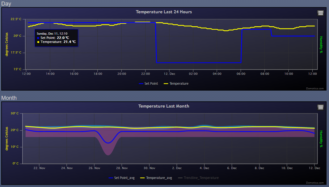

Just for the OP to see how stable temperatures can be with UFH...
This is my ground floor - 70 or so square metres of open plan living space.

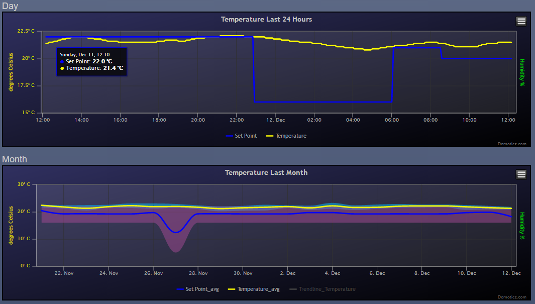

Lovely, that is all it takes, a bit of audience participation. There is little one can argue about if the figures are displayed and factual. That installation is however in your home fitted by yourself. That shows you have done a decent job and the figures are taken during a steady cold spell. What is the stability of UFH like now it has raised 8 degrees in temperature? Does it behave itself? Is it merely a case of lowering target temp or can you leave it without a drastic overshoot? Do warm up/down times catch you out?

It only overshoots due to occupation. The UFH is off. I could tell you about a system that is being fitted that mitigates that too, but I can not due to legal reasons.
What if I were to tell you the existing system as is has weather compensation that runs rads upstairs and UFH downstairs and an unvented cylinder?
Warm up times do not catch us out as the house has sub zoning that gives each room the chance to control its own needs - the system thinks that everywhere is UFH even if it is rads.

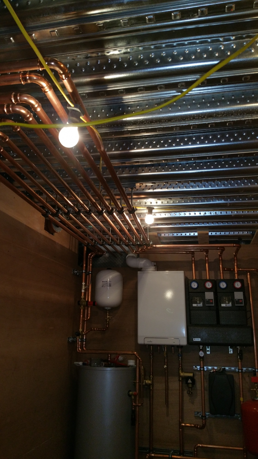

How about this system:
Picture taken while in progress, 236 square metres of UFH with a couple of rads.
All working perfectly.... Customer is a regular whom we install several complete system a year for - nearly all UFH - in fact the job I am starting next week for him is 50/50 UFH and rads. All to be run from those pump stations with no local temperature control at the manifolds, btu each room zoned accordingly.
Last year we signed off another for this customer 8Km of UFH in one house. All happy as Larry.
