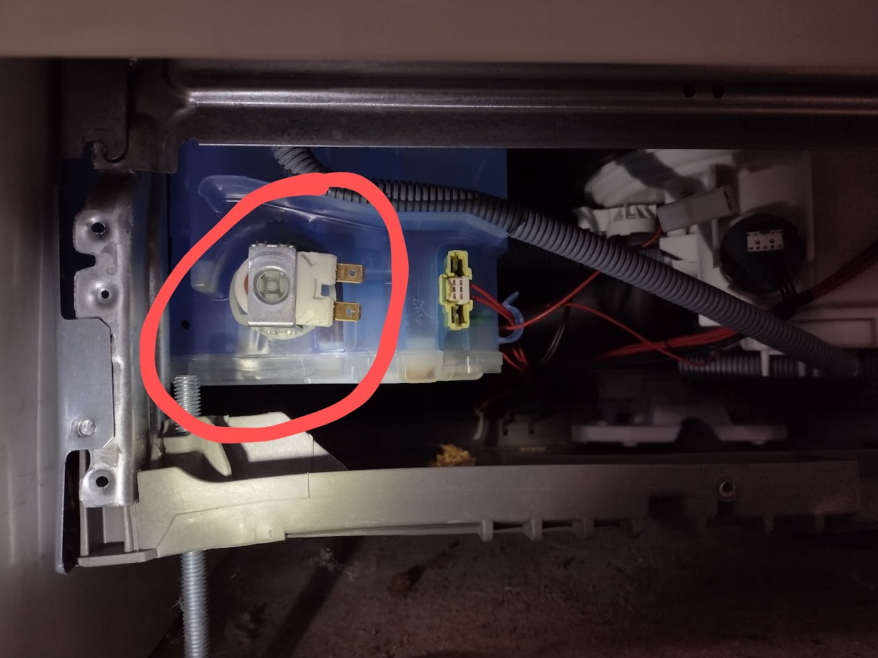

I've had a quick look, is this it, circled? I've unplugged it as you can see, need to see what I've got to draw the water out of the reservoir
Assuming that is it, which I think it is as it's on the salt reservoir, I've had the valve out.
It appears normally closed, with a plunger going into an inner pipe. So I'm imagining that when the coil is energised, the plunger comes back, allowing water to flow? The plunger doesn't appear to be stuck back, so I'm not seeing that it is stuck open, unless I'm not understanding the operation.
I haven't got anything here to test the solenoid, I'll have to bring something home from work or take it to work, as I'd like to energise the coil and see that the plunger moves, or not. I've measured the coil at 3.5k ohms.
One of the appliance videos suggested that the solenoid plunger can get stuck, so perhaps that's what's happened.

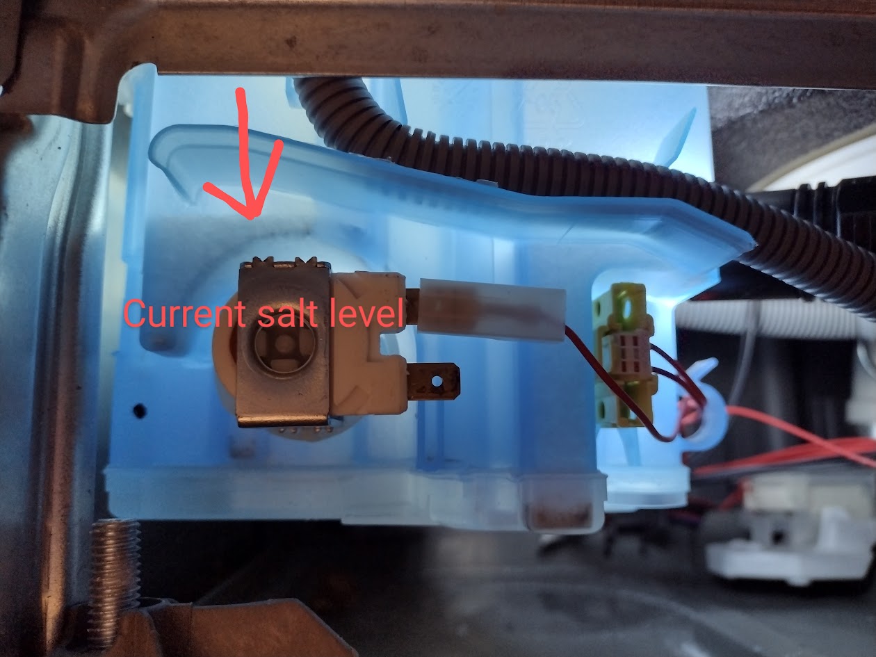

I gave the solenoid plunger, spring and the bore a good clean, put it all back, but didn't connect it.
I then filled the salt reservoir with some salt, enough for the light to go out. I'm monitoring the level with the valve not in operation, seeing that it remains closed off sufficiently.
