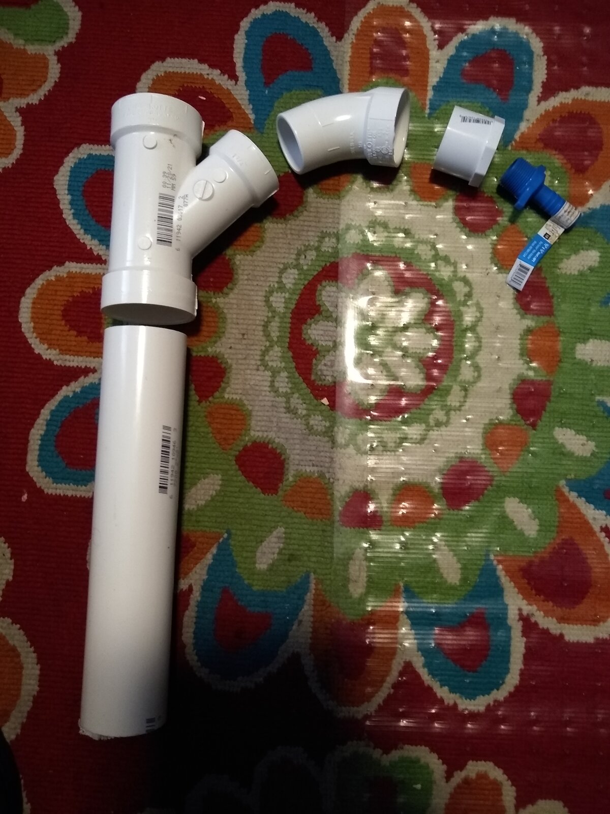

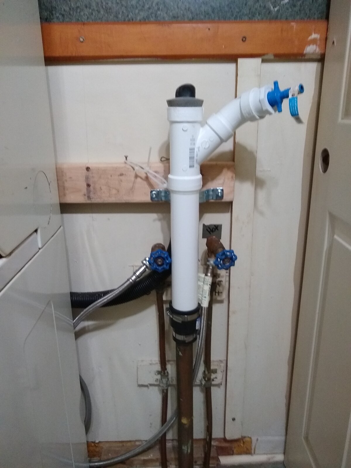

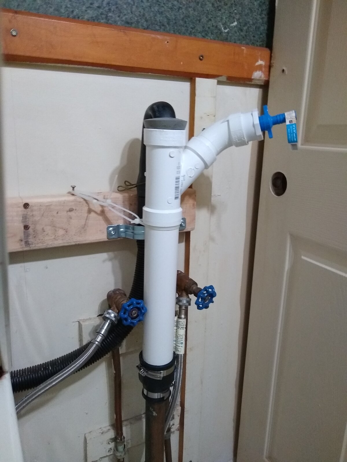

Setup this dishwasher and washing machine hoses for a single Standpipe waste drain connection

May I say, maybe someone can still find an answer that will work for them (USA); I found this sight and was able to apply documented 7 yrs. Old responses helpful and applicable.
