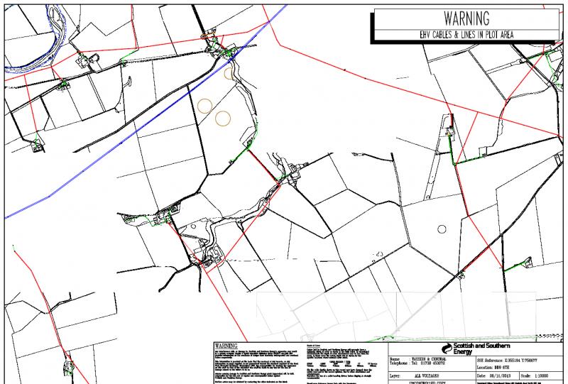

Little update.
been onto the DNO, very helpful indeed also.
I have supplied all info they need, and they say they will be back to me in 5 days.
lets see what they suggest.
So net up on site today with a very nice chap from DNO.
So underground cable is only option due to farm equipment in the area.
He feels maybe HV from other side if farm, all the way up to the plot, one pole on my land with my on tranny, then back down underground LV to external meter box.
Scared about quote due in 5 days.
I would sit down and have a stiff drink before you read your quote, I work for a DNO and it amazes me how much any works carried out by them costs, as has been said get any details of work you can carry out yourself, such as the excavations.
Thanks, all digging will be done myself, it's best part of 600m by the looks of it.
Been told I can get a quote from other people who are auth to do DNO work also, once in get scope of work.
Best get my bottle of dark rum in
About 10 years ago I was in a meeting where, (as I remember it) a distance of 500 Metres was considered too far to extend an LV supply. Anything over that distance it was considered cheaper to extend the 11KV into a new switch room. In our case it was a 600A (120KW) supply but even so, given the rise in copper prices since then I think you have have been given good advice by the DNO chap.
A customer of mine was recently quoted £7k to fit an (at a guess) 50KVA tranny to an existing 11KV overhead supply, and then run the LV 100M to a new house he is building.
All groundworks to be done by him.

He said to be, I can chose the location of the transformer on my land so it don't spoil my views, how nice of him, lol.
There is a slightly shorter run from the other side of the land, but would need permissions to dig others land, whereas if I go from this farm side, it is wrote into the title deeds that access must be provided to get services up, also the farmer is a nice chap.
Should be an interesting project I guess.

Reading the last 2 posts, I wonder where the "third drop wire" goes. Is it possible that your cottage was once fed from this? Unless it has been derelict for in excess of tens of years it would surely have had power at some time and there could be a terminated buried cable somewhere. It may be worth hiring a cable detector and having a search.
Talking to DNO man and farmer, it seems split phase is all that is available at farm, he had DNO add a supply to the steading 2 years ago, so I guess it's possible that's where it goes.
Where would I get a detector from?
