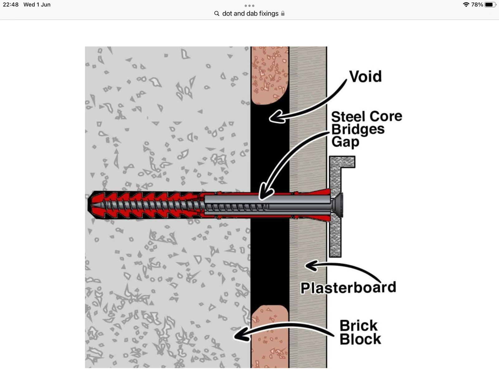

One thing to remember when fixing to dot and dab is that if you fix through a hollow part it can pull the plasterboard in a bit. There are special fixings to get round this.

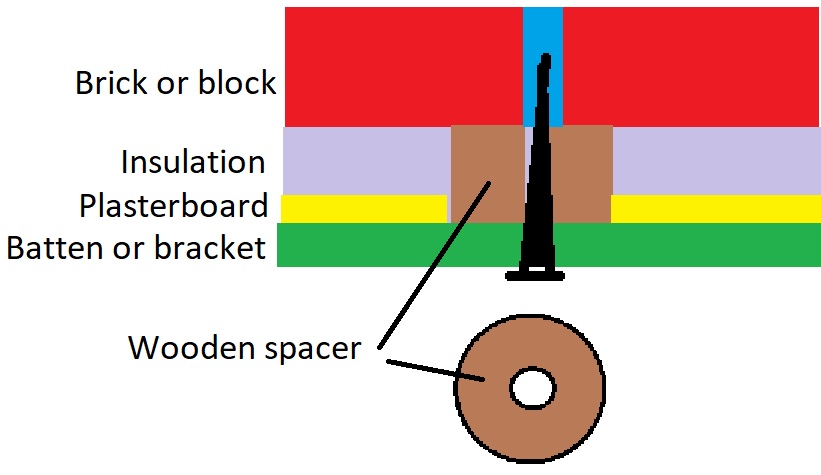

Use a spacer to transfer the load directly to the wall solid wall.

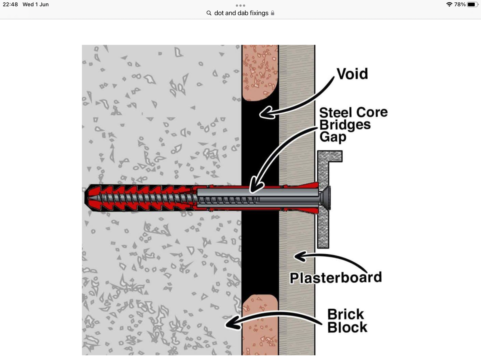

When the boards are fixed with dabs of adhesive there are parts of the board with a void between them and the wall. Fixings like Corefix are specially designed for dot and dab.

Once fixed, what fittings would work through 50-60mm of insulation and plasterboard in holding a heavy shelf? (The wall behind is very hard brick work)
You can get Corefix in 100mm and 120mm lengths. Not as cheap as screws and plugs, but ideal for dot and dab with heavy loads.
Depends how thick the insulation is, but I have 50mm insultation with 10mm plasterboard, so use 120mm screws with 7mm masonry drill bit and brown plugs. That has worked OK so far, touch wood! I have brick behind - if it is a soft aerated block then you might need to go deeper, but I suspect it would be solid brick on the outside if retro fitting insulation boards?

Primitive, even crude but it does work, The wooden spacer spreads the load against the wall and thus reduces ( eliminates ) the risk of the screw bending at the point it enters the wall,
Corafix appears to rely on the steel core and the screw not bending under the vertical force created by the weight of the item it is supporting.

Long screws and plugs - i.e. drill through the soft material into the hard material and knock the rawl plug all the way (fully) into the masonry.
if you hammer a plug through a cavity and in to the solid masonry, when you tighten the screw, it will probably pull the plug forward, ie out of the hole in the masonry.
