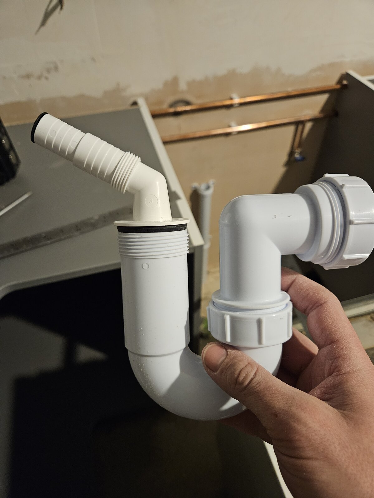

I've made a bit of a balls up when prepping the pipework for my new kitchen, I assumed that integrated dishwashers had space behind them for pipes!
Apparently I was wrong, so the standpipe type trap has had to come out.
I've bought a connector to put the dishwasher waste straight on to a 40mm 1½ BSP compression fitting, but should I still put a trap in?
Last thing I want is drain smells in my dishwasher!
Yes ,you need the waste water to go through a trap.

I'm currently trying to find a shallow trap which fits under the 150mm high units...
I'm very confused as to why no-one seems to sell an appliance trap which takes a flexi hose outlet

Sadly not, for some reason DIY kitchens decided to leave very little utility void!
I've found a flexi hose spigot which fits on to the trap that came with the standpipe (with a little modification!) I'll see if that works!

Has to discharge at high level to avoid siphoning .

Will it matter if there is no way for air to get in?
Yes needs air admittance .

Alter the base unit back to accommodate the standpipe/ trap combo.
Is the wall hollow ,could trap be set back ,past the plasterboard ?
Not at low level , can you put another waste thru wall to drain to accommodate ?
