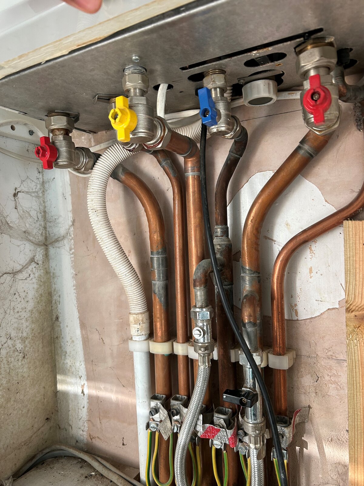

Good afternoon, I have the F37 error on my boiler. The pressure is around 0.5- so suspect this needs to be increased however I cant determine what valves relate to the water pressure. Have included a picture below if this helps. Thanks!
The silver braided hose is your filling loop.
Turn the slotted chrome screw 90 degrees, open the black-handled valve cautiously. you will hear water flow.
When you get 1 bar on your gauge return both valves to their previous closed positions.
