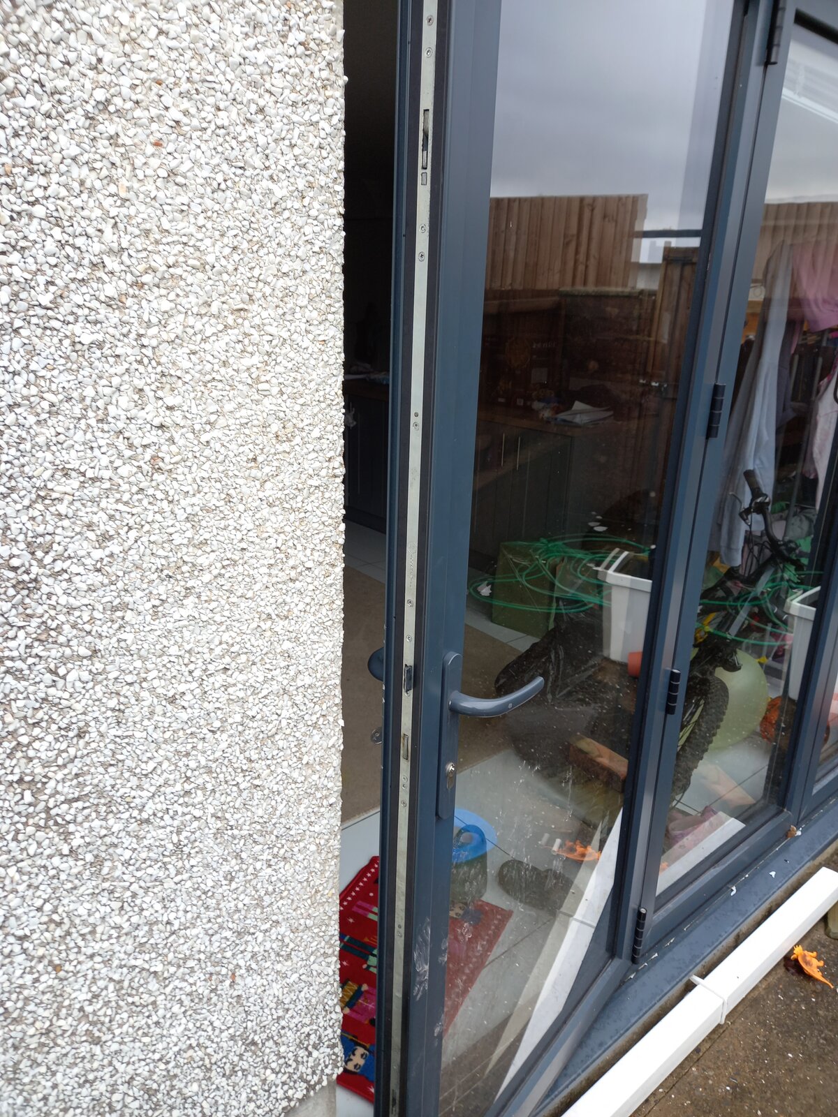

Hi All,
A metal framed glass door has been problematic to lock as the weather gets colder.
Today's first frost is now preventing us from locking the door.
When the door is open, the mechanism will close/lock correctly, but when closed it is jamming on something.
Would it be the door or the frame that needs adjusting?
And what in particular?
Cheers All
Doug

Metal will contract in cold , alignment needs checking.What type of lock?
Its a multi levered locking mechanism as shown in pic.
The weather has warmed up so the lock is now working, but still not a clean movement when closed as it is still catching slightly when the handle is raised to engage the levers.

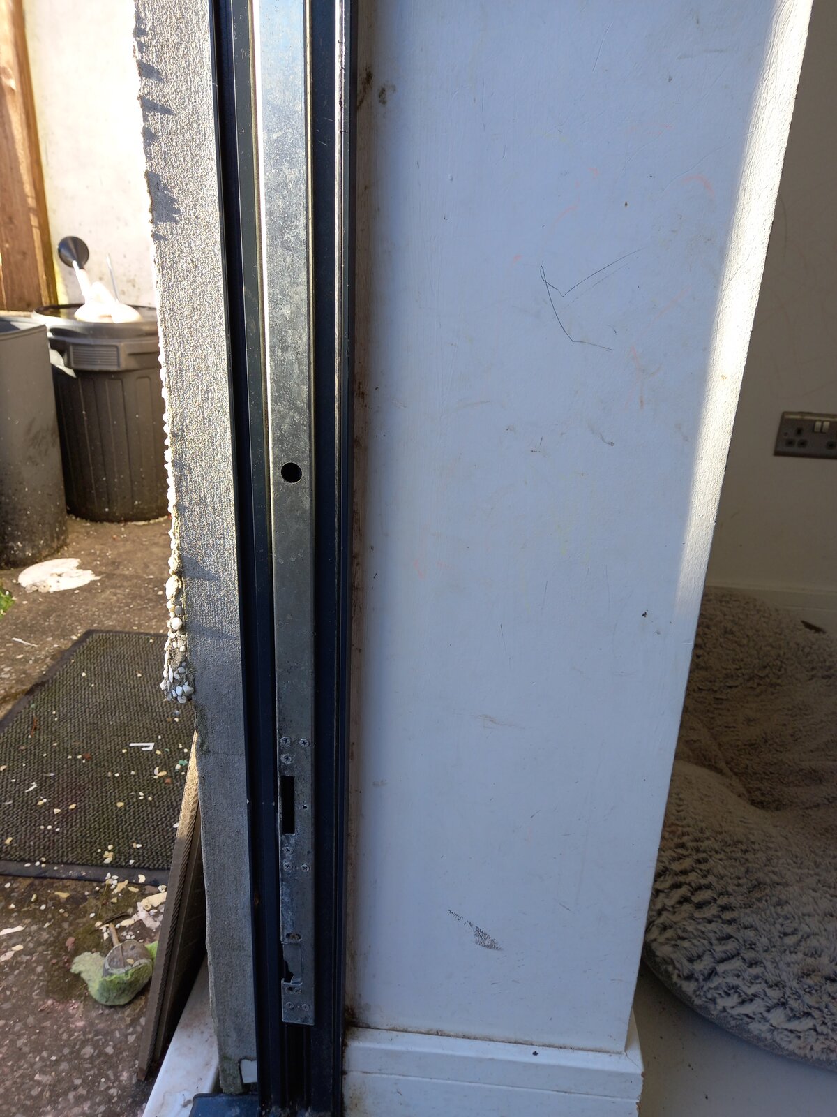

The handle full movement is ok when the door is open and the levers protrude/retract smoothly from the door frame. I am confident the problem lies in the door levers/wall frame alignment. Hence my query regarding adjustment.

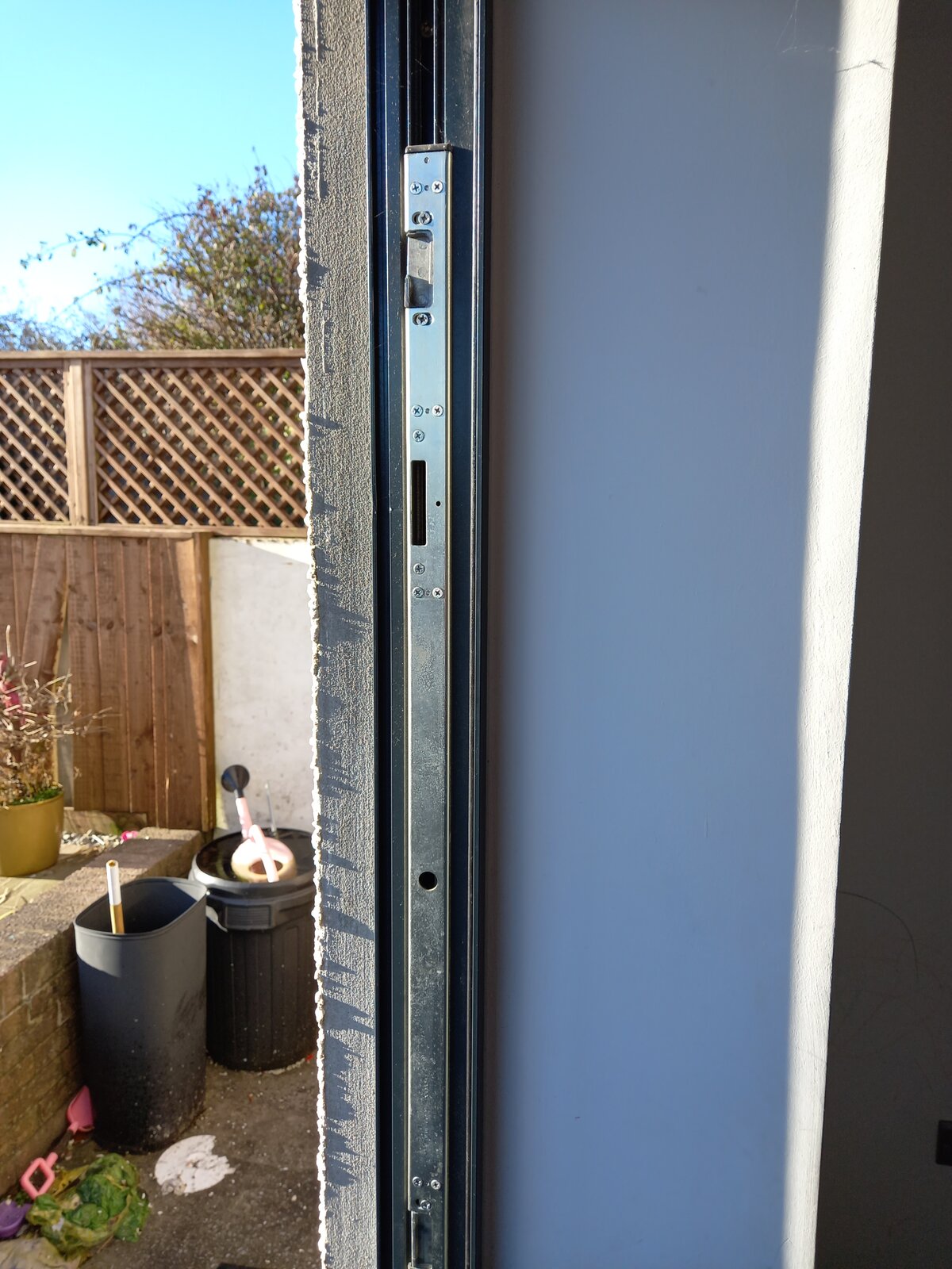

Is there a means of adjusting the wall plate which houses the lever receptacles?
Wait for the lock guy to finish his beer, perhaps he can tell you.
Before you make any adjustments or do anything, you need to find out which bit is blocking/catching. Screws that are in elongated surface holes are places where things can be adjusted.

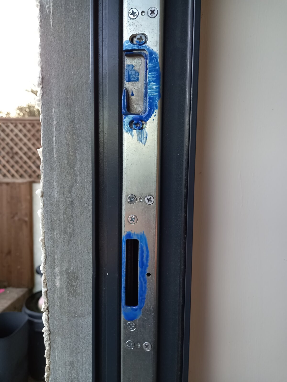

I didn't have any 'engineers blue' but used next best thing...kiddies play paint!!
Coated the surroundings of the catch plate and with the door flush and closed, moved handle up/down several times.
On checking the door levers, both top and bottom levers have blue on the outer faces.
This suggests the catch plate needs to be shifted outwards ie to the left in the pic.
The adjustment screws appear to have a little room for shifting the plate, but I run out of time as the missus was complaining about the cold.
Hopefully a quick fix this weekend. :giggle:
