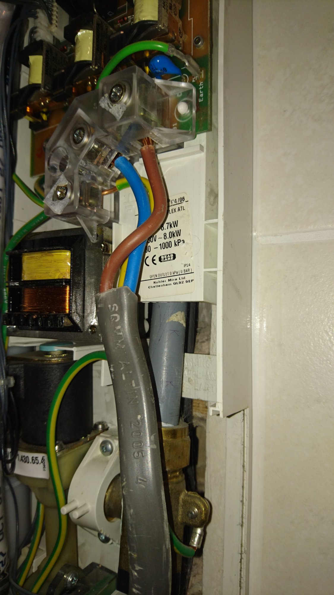

My Mira electric shower recently packed up and im looking at getting it replaced with a new unit but would like a bit of advice before i buy a new unit.
The plumbing and wiring from the existing unit are all in place so im hoping that aside from any remedial work to re position the new unit and make good any exposed holes in the wall, that the replacement should be a fairly straight forward job.
The only significant difference between the old and new units is the old one is rated to 8.7kw and the new one is 9.8kw.
I believe the difference in power will have an impact on the wiring requirements so ive gathered a few pics to show what ive currently got in place:

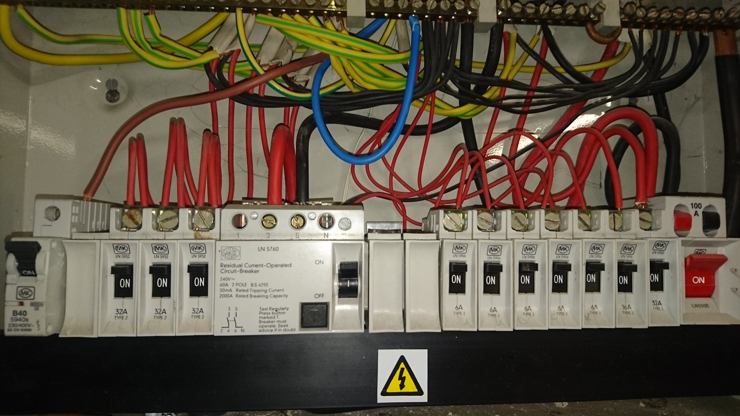

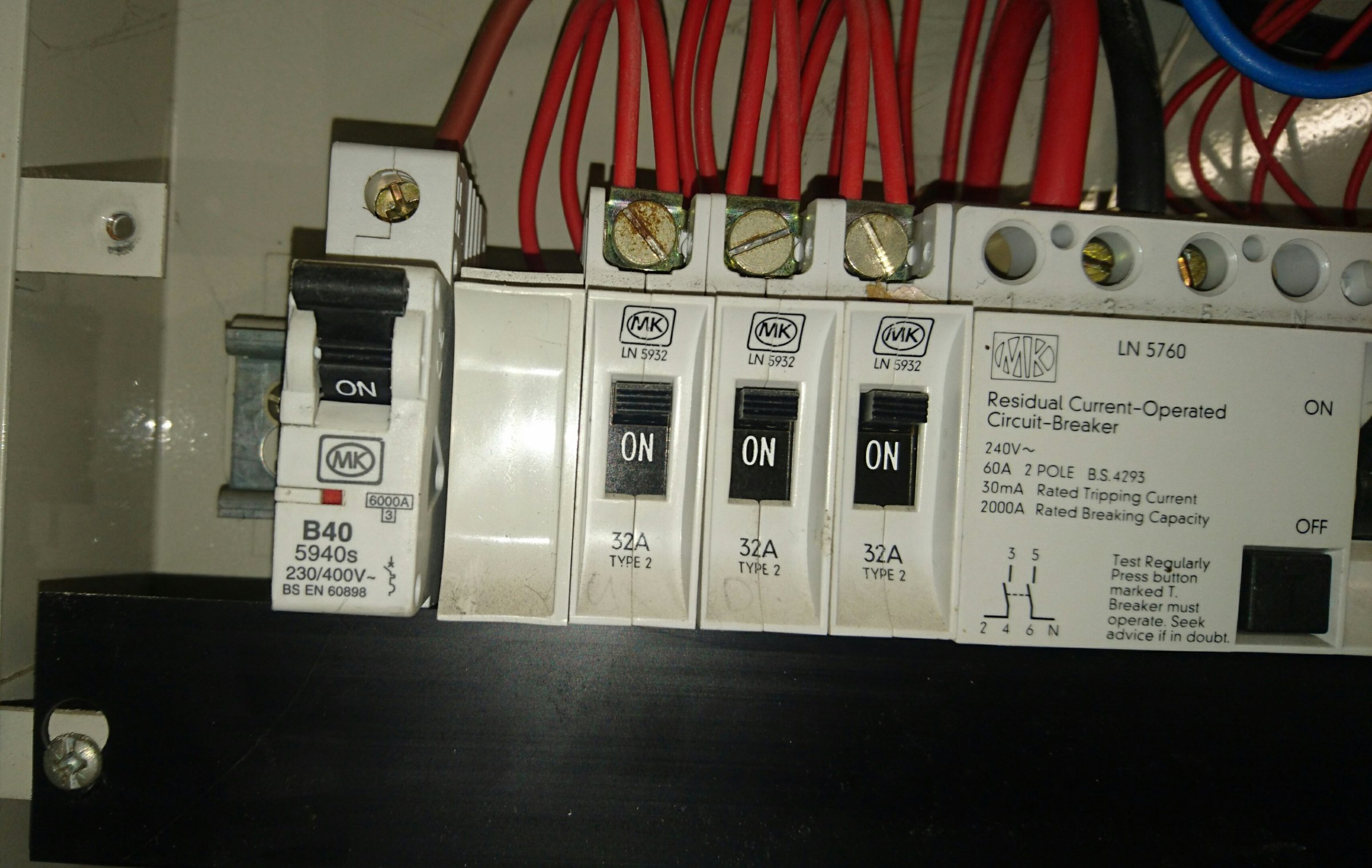

40a circuit breaker at the CU (far left)

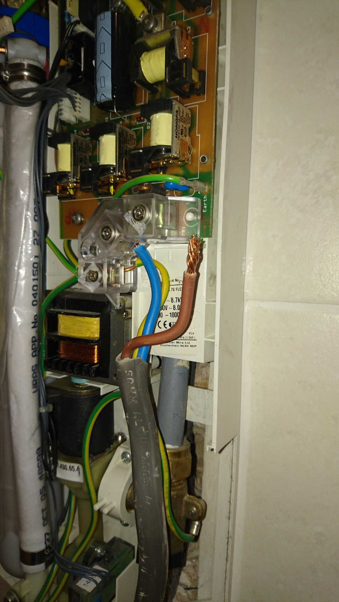

at the shower end ive taken a couple of pics of the cable where it terminates in the unit
also measured the approximate outside dimension across the cable which is approximately 14mm overall
Can anyone advise if what ive got is suitable for a straight replacement with a 9.8kw unit before i go and buy something to get fitted?

The cable appears to be marked "2005".

Right, heres what ive found out:
according to my measurements, the cable is 6mm2 based on the info contained on the wiki page
i also found a part of the cable with the rating details on the outer sheath
The exact info on the cable is: 2X6mm+2.5 SQmm
in terms of how the cable is installed it goes like this:

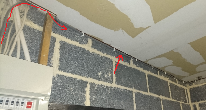

It runs from the CU for approximately 2.8 meters as seen here

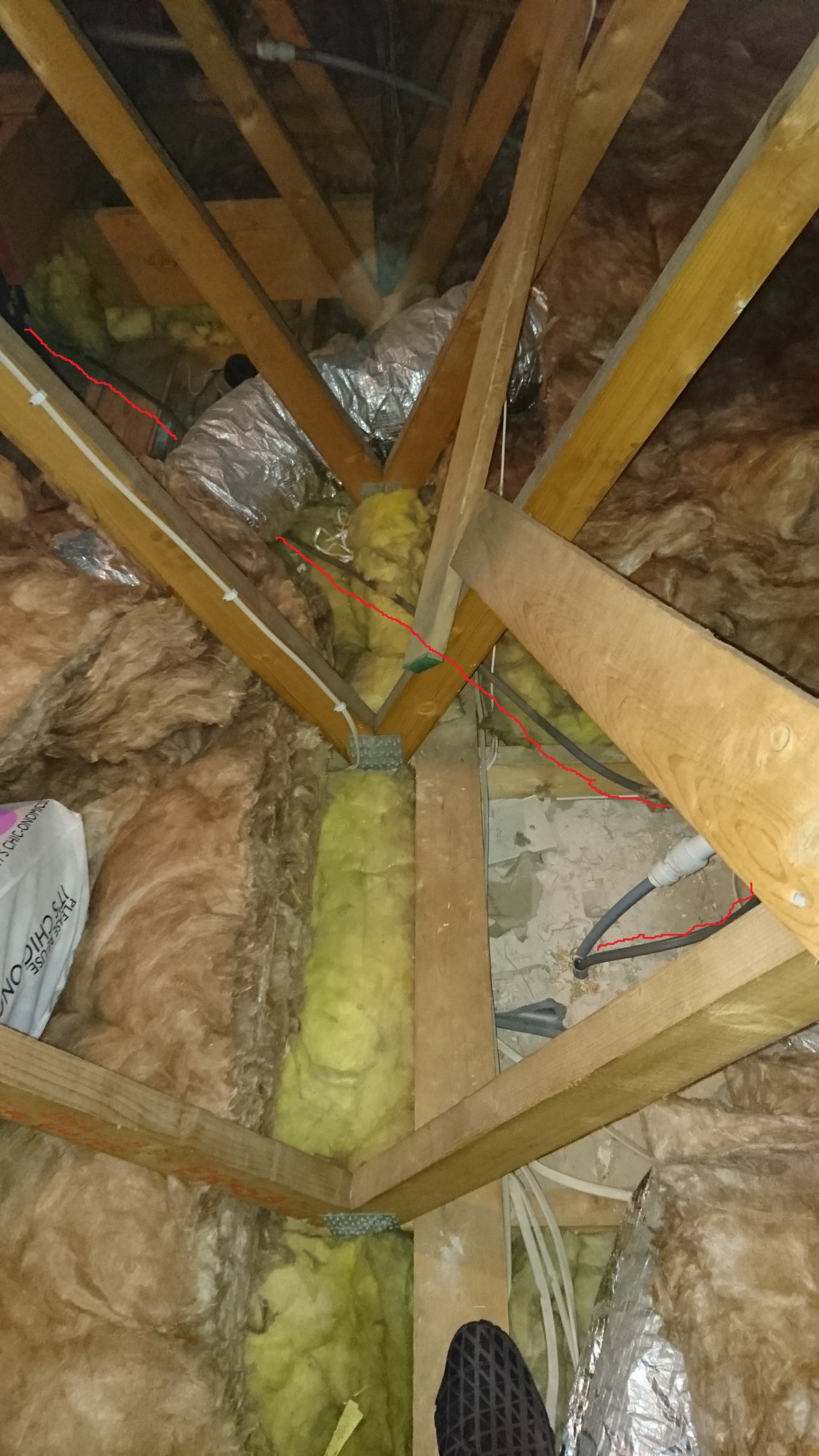

it then runs up the inside of a cavity wall for about 2.4 meters into a loft......

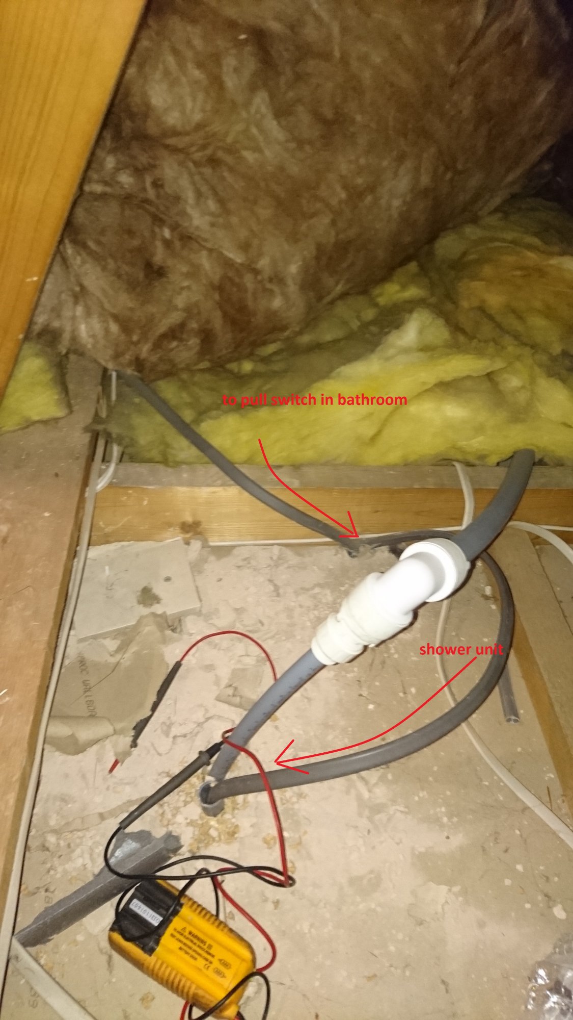

In the loft the cable runs largely uncovered for 3.1 meters
it then goes from the ceiling mounted pull switch directly down to the shower unit through some plastic trunking for a length of about 1.5 meters.
Do you think this arrangement of cable size and routing is sufficient for me to install a 9.8kw replacement unit in place of the faulty 8.7kw unit?
So worst case is "it then goes from the ceiling mounted pull switch directly down to the shower unit through some plastic trunking for a length of about 1.5 meters." so not really method C so as original it was just about on the mark, in real terms even with 6mm² cable because the shower is used for such a short time you would likely get away with it. However that does not make it right.
One can likely drive at 40 MPH in a 30 MPH limit without having an accident 99% of the time, the chance of things going wrong are remote. Same applies here, it is a remote chance that it will go wrong, only you can decide if worth the risk.

Replacing the cable with 10mm² and installing it so it is clipped properly in the loft etc. would be more acceptable, if you want to keep the new rating. If you replace with the same rating you won't be any worse off than before. I would not feel happy connecting the 9.8KW shower to your existing wiring.
Cables shouldn't really be run in the cavity as they might get damaged from the rough surfaces, or could be affected by cavity wall insulation if it is added at some point. Using the correct type of MCB is always good, your existing shower MCB does not fit your consumer unit so it has probably been butchered in some way to make it fit. A 45A MCB is available, but may be harder to find as this type of MK MCB is obsolete, they are selling on ebay for silly money. I have loads here and some RCBOs I'll have to get listing!

I think I'll keep the existing wiring, properly clip it place where possible and replace the old unit with one that has an equivalent or lower power rating
.... it then goes from the ceiling mounted pull switch directly down to the shower unit through some plastic trunking for a length of about 1.5 meters.
Is that 1.5m length of conduit/'trunking' buried in a solid wall, or what?

... as I said before, assuming that the 9.8kW is quoted at 240V, that corresponds to about 39.1A at 230V, hence just OK on a 40A MCB. ~8.3m of the ~9.8m total cable run appears to be essentially Method C, so no problem with 6mm² cable. It's just that 1.5m cable drop in conduit that is a possible issue. That would probably be regarded as Method B, hence theoretically 38A max, but that's only fractionally under the 39.1A.
