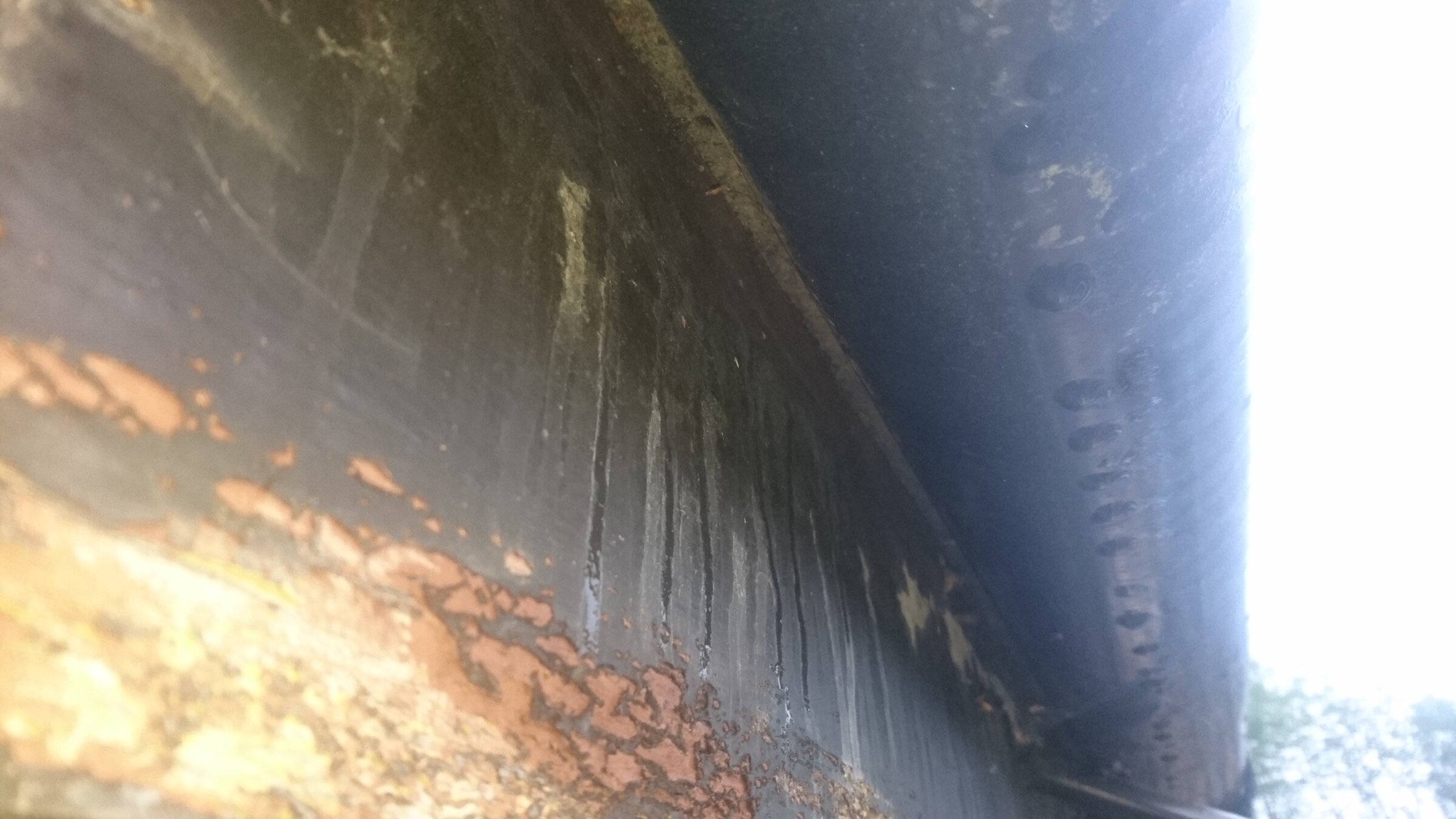

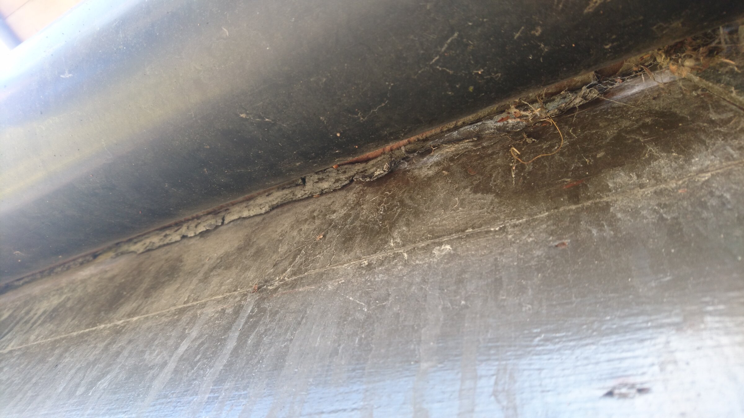

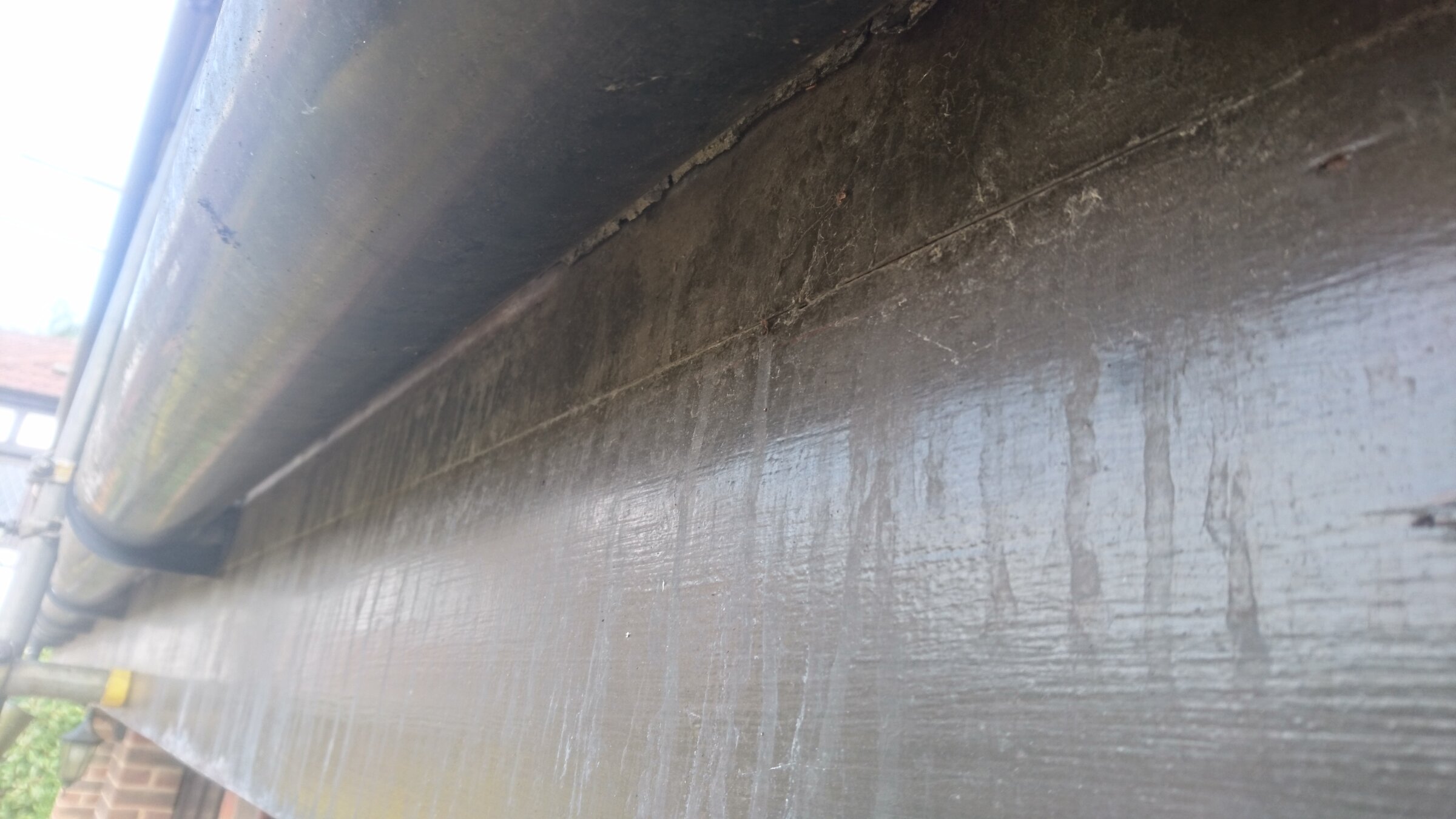

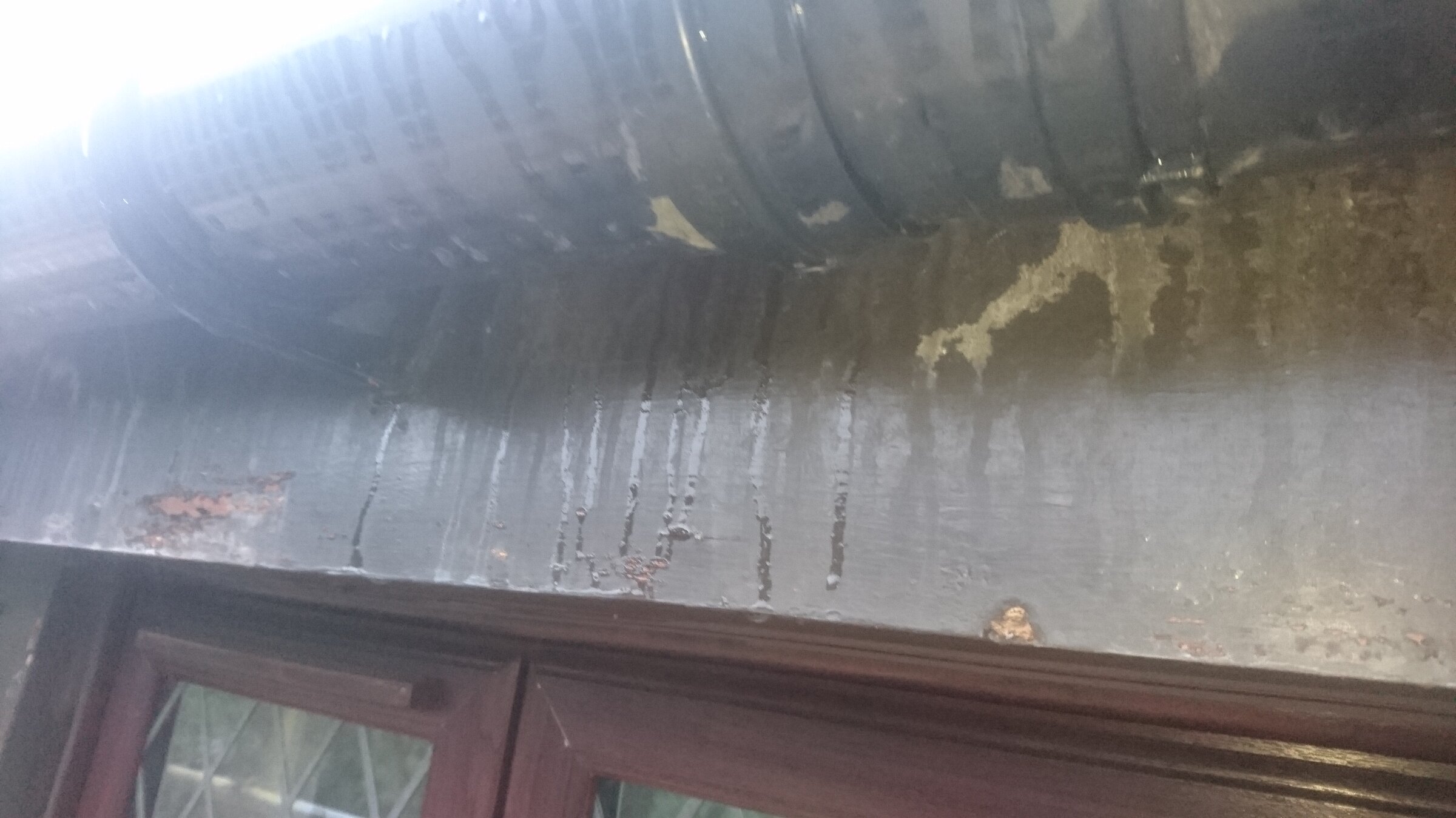

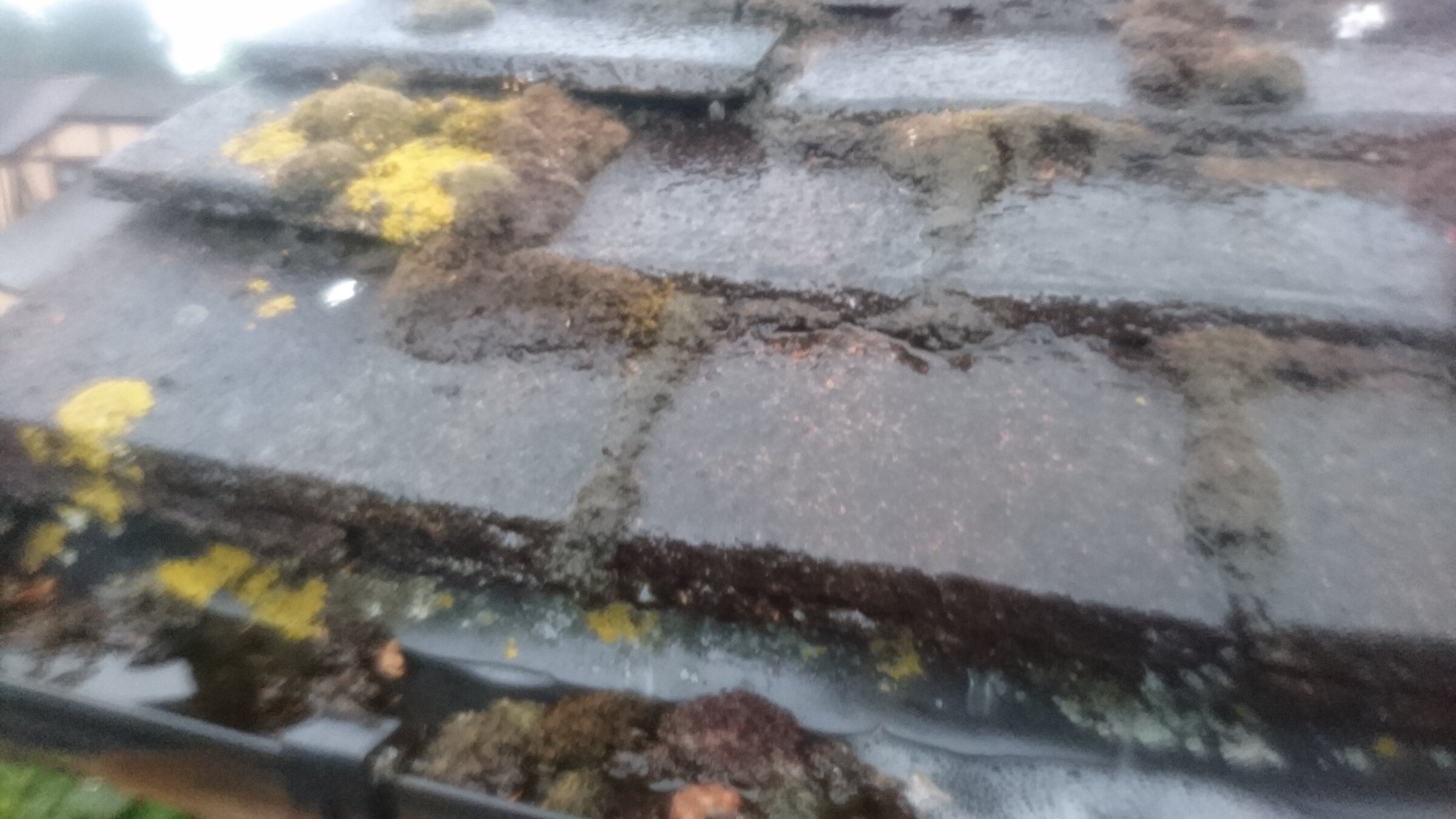

Water is getting on to the fascias of my house leaving water stains. This happens pretty much all the way around the house.
Initially i thought due to the gutters being full of crap and overflowing but the gutters are not blocked enough to overflow
Ive got a scaffold up for decorating and was able to have a more detailed look go try and see whats going on while its actually raining.
The gutters need a clean out but they dont look bad enough for them to overflow onto the fascia
It looks like the water is getting under the tiles and leaking down onto fascia.
Any ideas on how to fix this?
Would like to get it sorted so that im not left with water marks on the new paint work

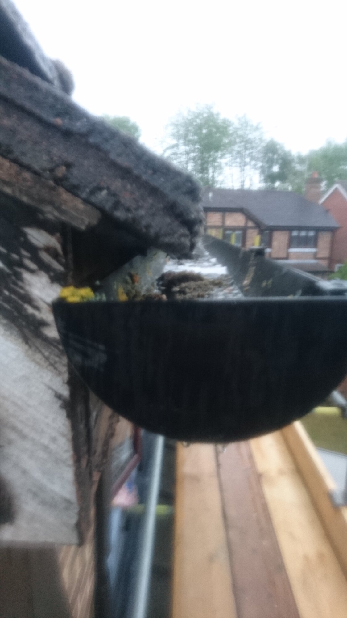

At a guess, looks like the roofing felt has perished, so water getting through the tiles is not making it into the gutter, you could try fitting Eaves Tray.

No breakages that i can see and all ridge tiles are there.
Im going to get a cat ladder up to clean the moss while ive got the scaffolding up so I'll do a thorough inspection then.
Could it be that the interlocking channels of the tiles are blocked up with moss thus not allowing proper drainage?

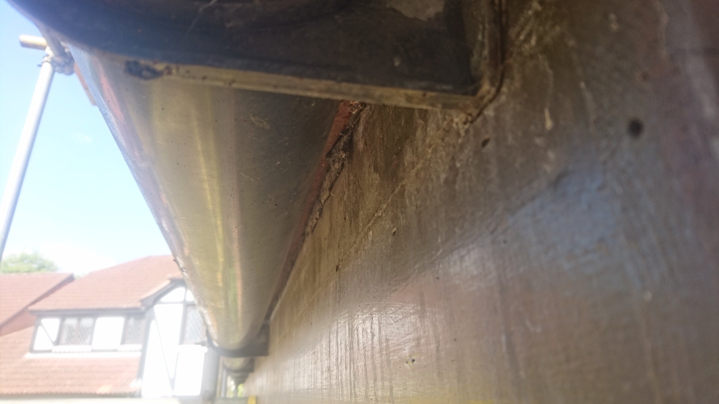

Looking at the end view picture I'd say the undercloak row of tiles is missing. Can see what looks to be an cement board undercloak but that ends in line with the fascia rather than the end of the tiles. You need to get the Eaves tray under the undercloak to ensure the rainwater goes into the gutters. I don't think the roof has 'Sprockets' at the end of the joists or trusses which can make your problem worse.

So i just did a bit more research on fitting the eaves trays before i go out and buy the supplies.
All the video clips online make it look easy enough but what happens at the ends of the roof where the tiles are bedded into mortar??
No one seems to mention that bit.
Any suggestions on how to do this at the ends of the room where the last tiles are bedded in too mortar and i wont be able to lift the cement board enough to get the eaves tray under.
