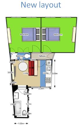

Hi,
I'm thinking of converting a 236x85cm closet into an en suite and I'm struggling with the ventilation, as there is no access to an external wall or loft space. Three internal walls are adjacent to the master bedroom, hallway and (soon to be after the wall is taken down) kitchen/lounge, while the fourth wall is shared with another building. There are other flats above and below.
Is it advisable to extract the air into the bedroom or the kitchen/lounge? If not, I may have to skip the shower.

The rooms indeed taper like that, almost all the walls are out of square, which will make fitting the kitchen fun.
There should be enough space in the ceiling for a duct to run along the joists, but I would have to go across at some point to reach an external wall. The kitchen/lounge and the small bedroom (to become the main bathroom) do have external walls. Currently, the water and soil piping is on the south wall of the kitchen and bathroom.
Outside duct in the kitchen/lounge is a possibility but there'd be quite a bit of distance to cover (5-6m with a bend), so I don't know if any fan would be powerful enough.
I also thought about building a duct and venting into one of the chimney breasts, but they're both sealed in my flat and I strongly suspect it's the same in the flat above, so I don't know if it's possible.
Here's the new layout that I'm thinking of. I wonder if it'd be possible to build a duct on the north wall of the kitchen/lounge and link it to the duct on top of the kitchen cabinets?
