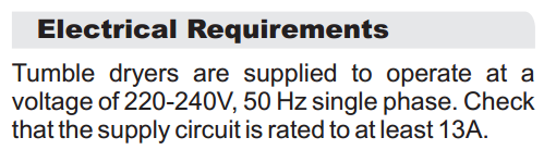

I have attached the Candy Dryer manual, cant seem to find the power requirements? anyone else manage to find them?

All I can see in that is Page 7 -
