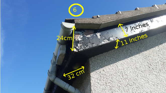

AAMOI: you most probably have quite a bit of cutting out and replacement - eg. see the barge board tail - before you could overclad or even do a decent paint job.
Dont leave even a trace of fungal damage/rot in the fascia/woodwork or it will come back to bite you.
Whether its your most cost effective long term solution, i dont know.
Houses esp. houses in exposed seaside positions, are like living things - they are constantly moving and changing. No remedial repairs will be permanent - perhaps long term but not permanent.

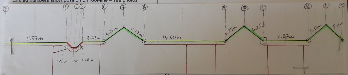

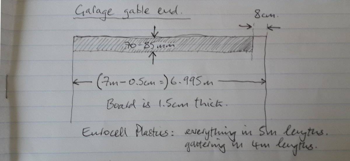

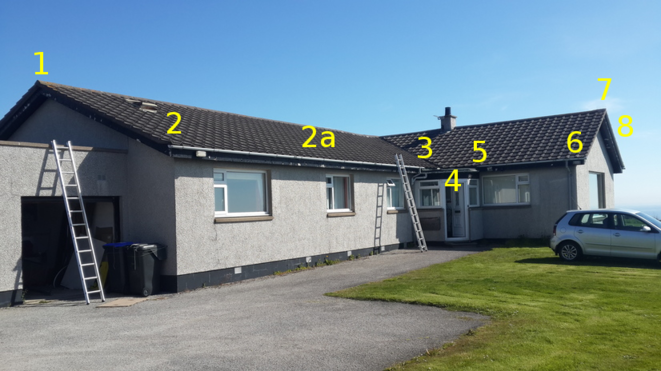

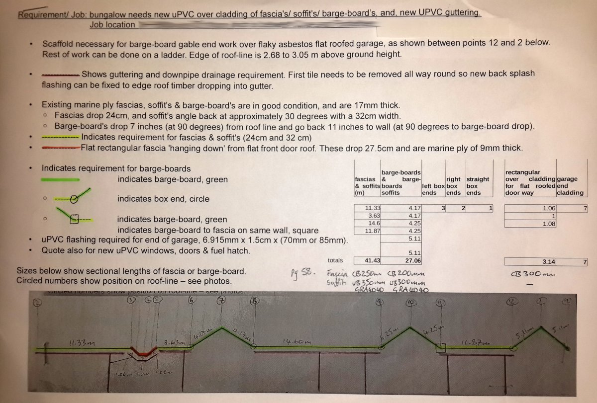

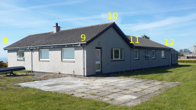

That's not the full quote, and it's for white, didn't you want black? Where are the prices for all the corners, joiners, J trim, soffit trim, nails, screws and guttering? What are the three prices for on the right? Cheers
Hi MW Roofline
I'm sure that the parts list I have spec'd is not full, as it would be, if done by a pro.
I did go up to eurocell and asked for some help with a white overcladding parts spec.
They said they were understaffed and I haven't got round to going back and trying again.
I have shown my roof line drawings to a few people and no one has got back.
So I've just got on with the list myself.
.. Yes I would need joiners. Not sure which ones.
Not sure why corners ; lengths of the L angle should do that?
If you have further ideas these are welcome.
Here is the spec I put together.
Thanks for the explanation. I still dont get it in terms of your posts but ... whatever.
HI Ree,
I can see you are right. I will make sure to cut out all the rot/ fungal / degraded wood before progressing.
