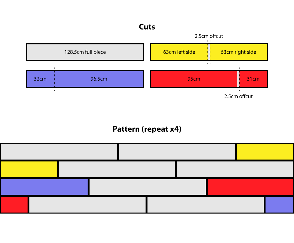

Just noticed a little problem. Each row is almost exactly 2.5 boards.
I think this means I can't just keep using the last cut of one row to start the next row, or I'll end up with an H-pattern / H-joints.
Came up with a solution where for the third row I take a cut off the first board and last board with a full piece in the middle, and use those cuts on the fourth row with 2 full pieces in the middle.
See plan attached. Is this a good solution or am I missing something obvious?
