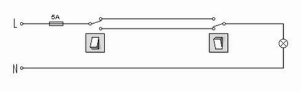

Basic wiring diagram notice three wires required between switches.

Diagram:

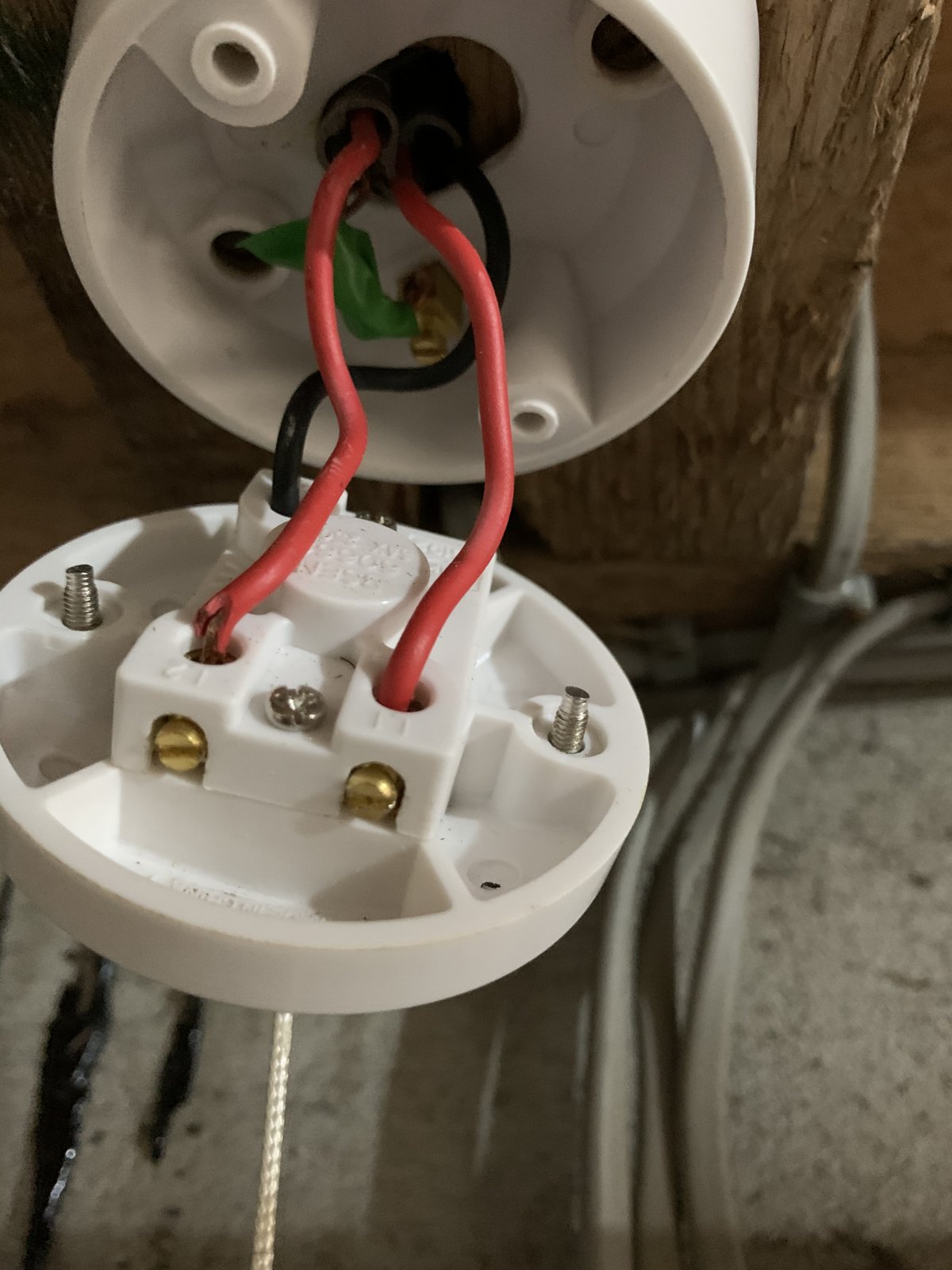

Mmmm. It's difficult because I can't tell which cable is which and the other wires have been cut off.
I would say that the red wire at the light should be swapped for the black from the same cable (or vice versa at one of the switches) but it is impossible to be sure.
Can you tell where the cables come and go to?
Do you have two cables from the supply, one to each switch?
Second thoughts - I don't think that is correct - it wouldn't work at all if that was the case.

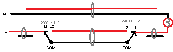

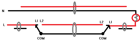

This is my GUESS based on the pictures
cables circled with grey and spare wires shown. Switch number, L1's and L2's have been randomly applied.
And again this is my GUESS.
If this is what you have the fix MAY be simple.

Looking at your pics again I can see I have at least one switches L1 & L2 round the wrong way.
