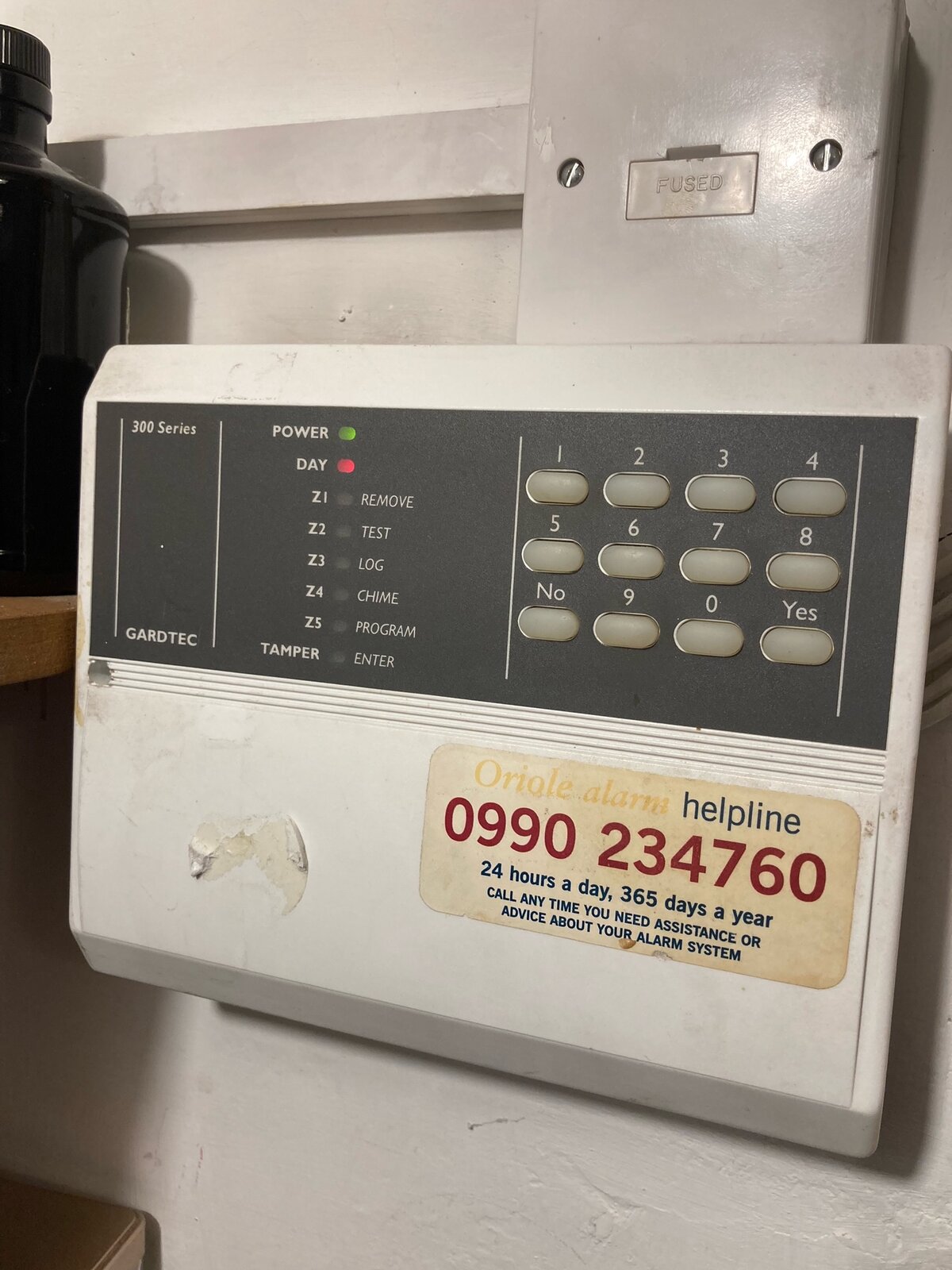

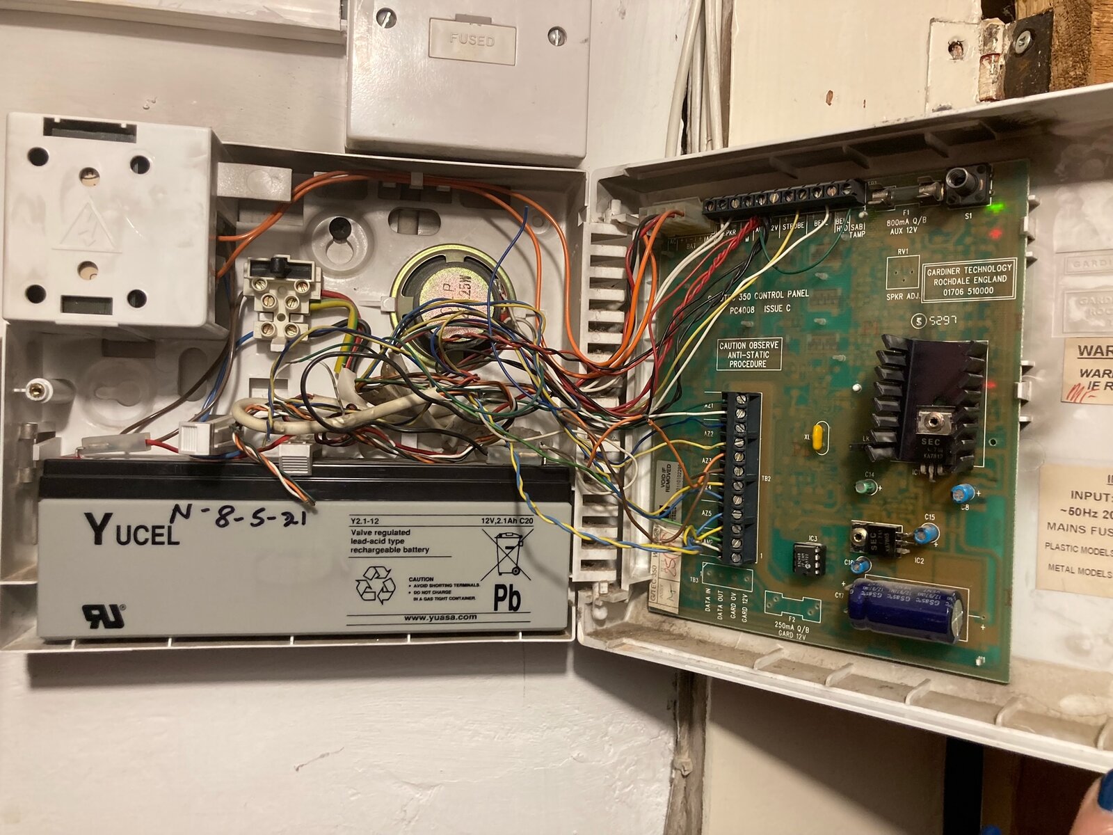

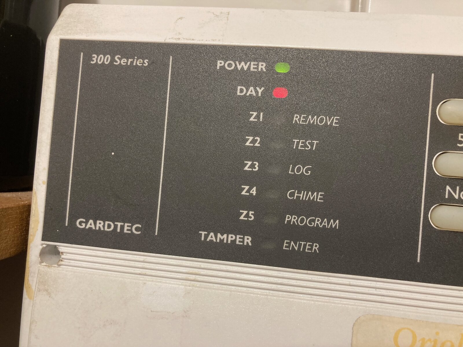

My alarm continuously flashes when it powered up again after a power cut when some wires in the floorboards got wet (and dried).
When I have the funds, I will replace it, for now its good enough.
Had a quote of £200 to change the panel. How easy is it to replace ie can I do it myself. However I'm wondering if the issue is deeper than just the panel as its working but very low volume plus the outside alarm bell doesn't sound after the maximum time....maybe not a panel issue?
Advice would be helpful or a more reasonable price. I'm based in E6 East London.

What is flashing? It shouldnt power down when theres a powercut, thats what the backup battery is for
The battery literally has the date written on it 8/5/21. And the video doesnt seem to work
yes I saw that after and thought it only seems like yesterday!..2021 the video should work now?
