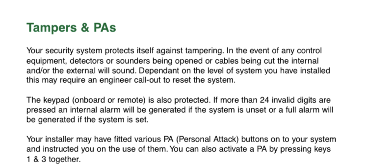

Thanks for your response.
I’m just been concern if I could reset with normal code or system recognise this as a tampering and need an engineer.
Do you have the user code?
Open lid,enter code to stop internal noise
Change battery by removing spade connectors of old battery, re connection new battery
Close lid,reset system with user code.
Ensure lid is closed correctly.
