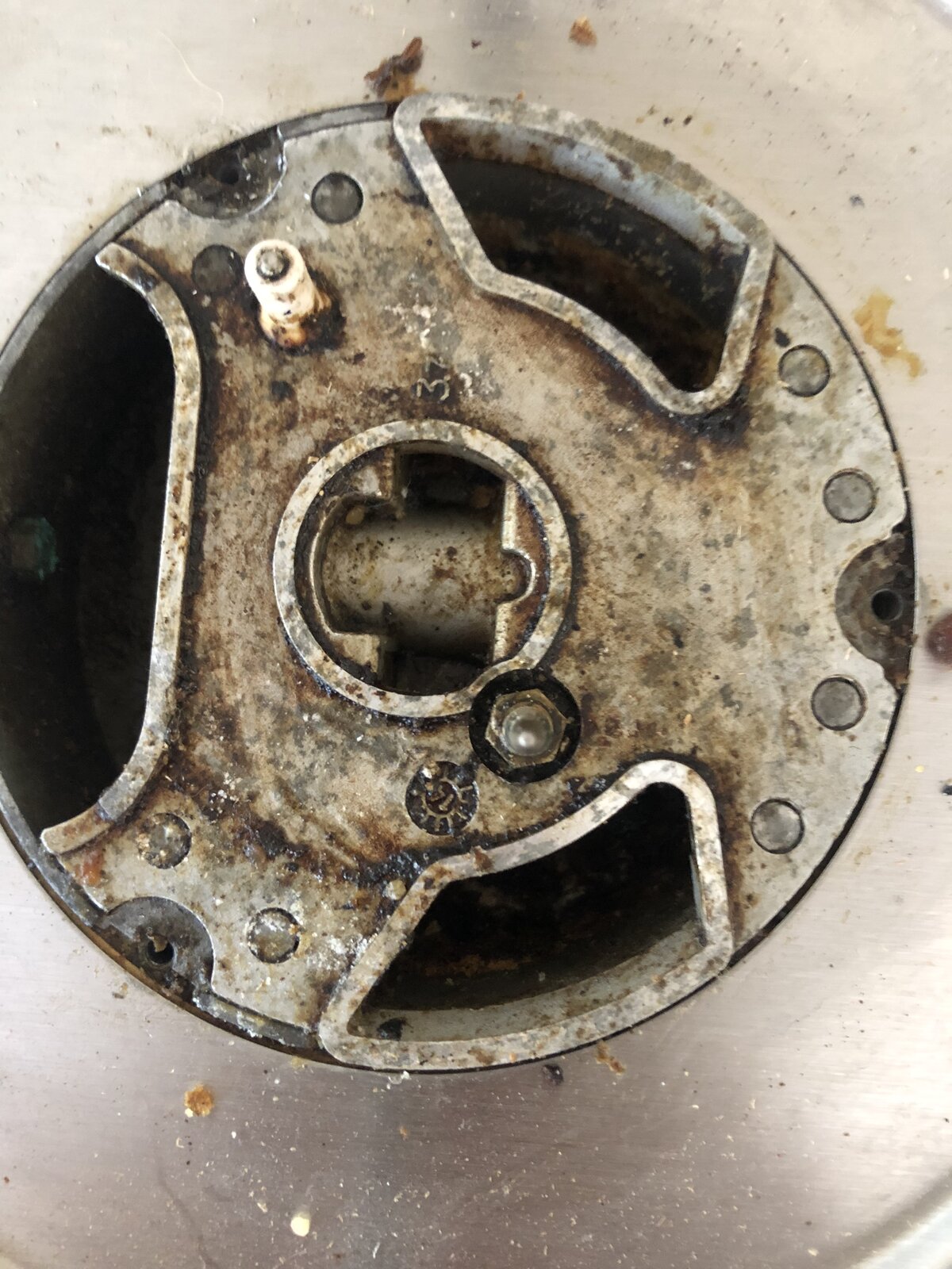

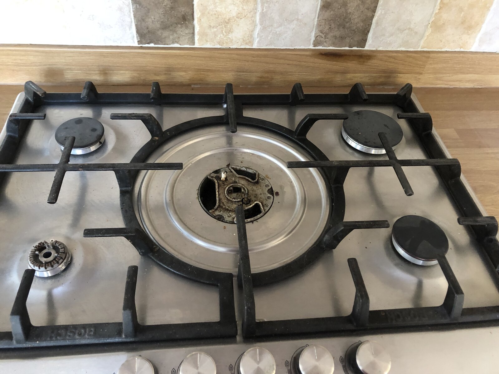

Attached are photos of the Bosch hob.
4 side burners work perfectly.
Centre one ignites I hear gas ( I think) but does not light. Any ideas. Thanks

It can’t ignite and not light. Does it spark? Can you light it with a lighter/matchstick?
Ah yes. Didn't spot it from the top-down view.
In that case I'd suspect failure of the flame sensor thermocouple or the hold-on solenoid valve it energises.

Sorry I mean it sparks. I can hear the gas but does not light.
Clear all the confusion up does it light with a match and then stay lit ?
  • Like
Reactions: CBW
Yes Have just tried it. It lights with a match. Stays alight. When i put the cover on it does not light at all.
In first attached picture i can get a flame in 3 places. Centre circle and the top and bottom shapes.
