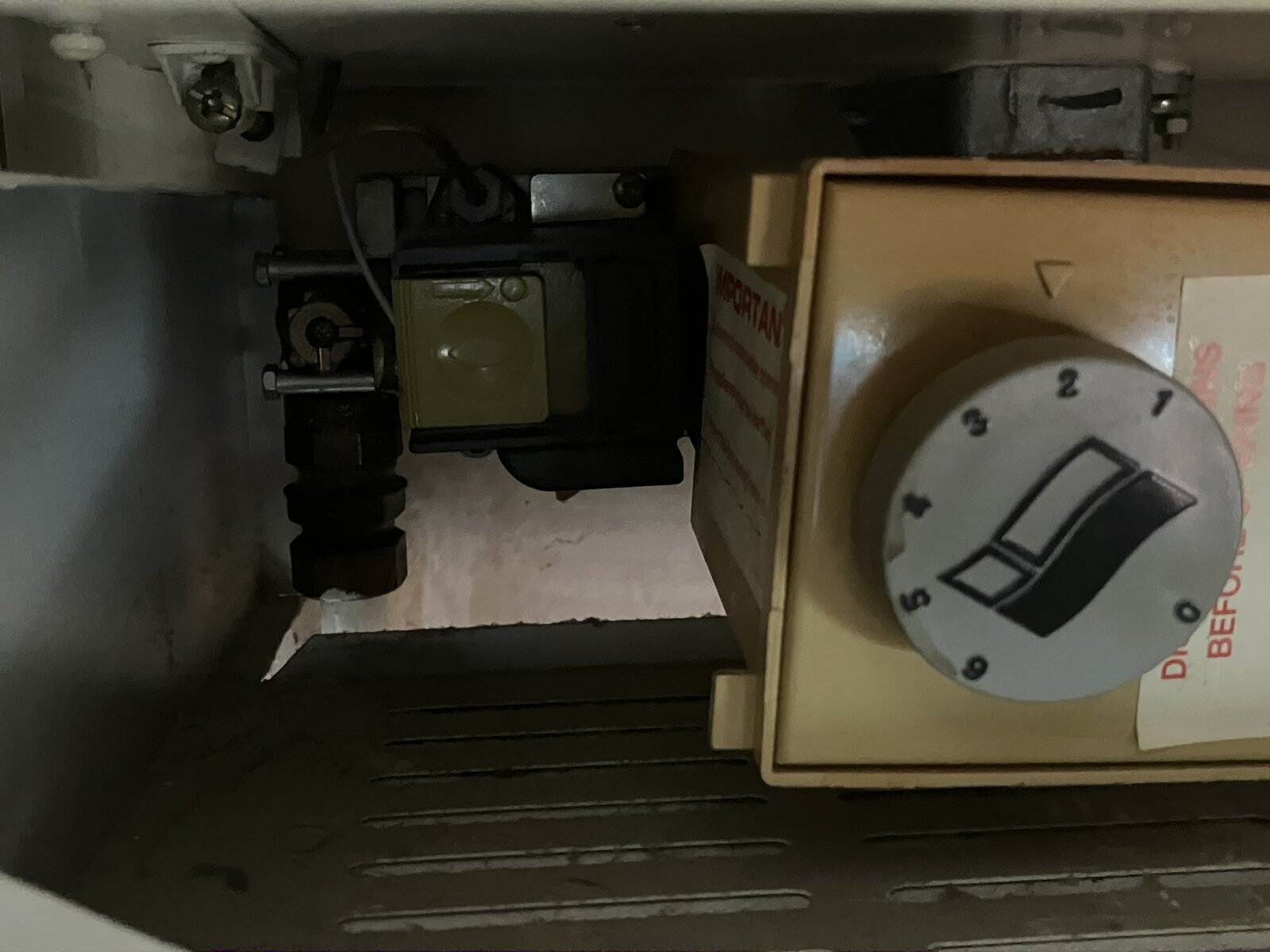

Recently noticed a gas smell coming from my ideal classic RS50 boiler. Cadent have been out and confirmed a small leak and capped off the gas. The question I have though is that the gas smell only appears when the boiler fires up not when the pilot is burning normally. Gas smell continues as boiler burns higher. Any advice on what it could be? I thought it may be a faulty gas valve. Engineer is coming out tomorrow but I’m just curious as to what people think.

Right, I will get them to check that @HandyMan23 . The smell only seems to be coming from the left hand side of the boiler in this area that’s why I thought it could be the gas valve leaking when more gas is put into the burner

@Madrab thanks . No pressure drop on test but using a sensor he detected small amount of gas coming from the area at the bottom of the boiler as in the photograph. As it was coming from outside of the sealed boiler casing, he did think it was perhaps the gas valve leaking , (all of the pipes and joints were tested with spray to detect gas and were fine ) but we will see. Hopefully that makes sense?
Ah apologies, didn't get to that point properly. If it's between the gas valve and the burner then it would normal showing up as a bad joint or similar and would normally be seen with the LDF. Wouldn't be any other reason to smell gas inside the property.

I understand thanks @Madrab I’m assuming as the burner is actually inside the sealed casing and the gas was coming from outside the case and that’s where the valve is. Like I said, he sprayed all the joints and saw nothing but let’s see what my GSR engineer detects. I did actually know the Cadent guy because he lives nearby funnily enough and he said he couldn’t think of anything but the gas valve having checked it but hopefully the GSR engineer will sort.
Just interested because it seemed a bit of a mystery. As I say, it only occurs whilst the boiler is fired up and when it reaches temperature and is idle there is no smell. Very strange
Yes, if I remember rightly those boilers have the gas valve bellow and external to the room sealed case, therefore if gas was being detected then it would be reasonable to presume that there would be a leak on the gas train into the combustion space.
