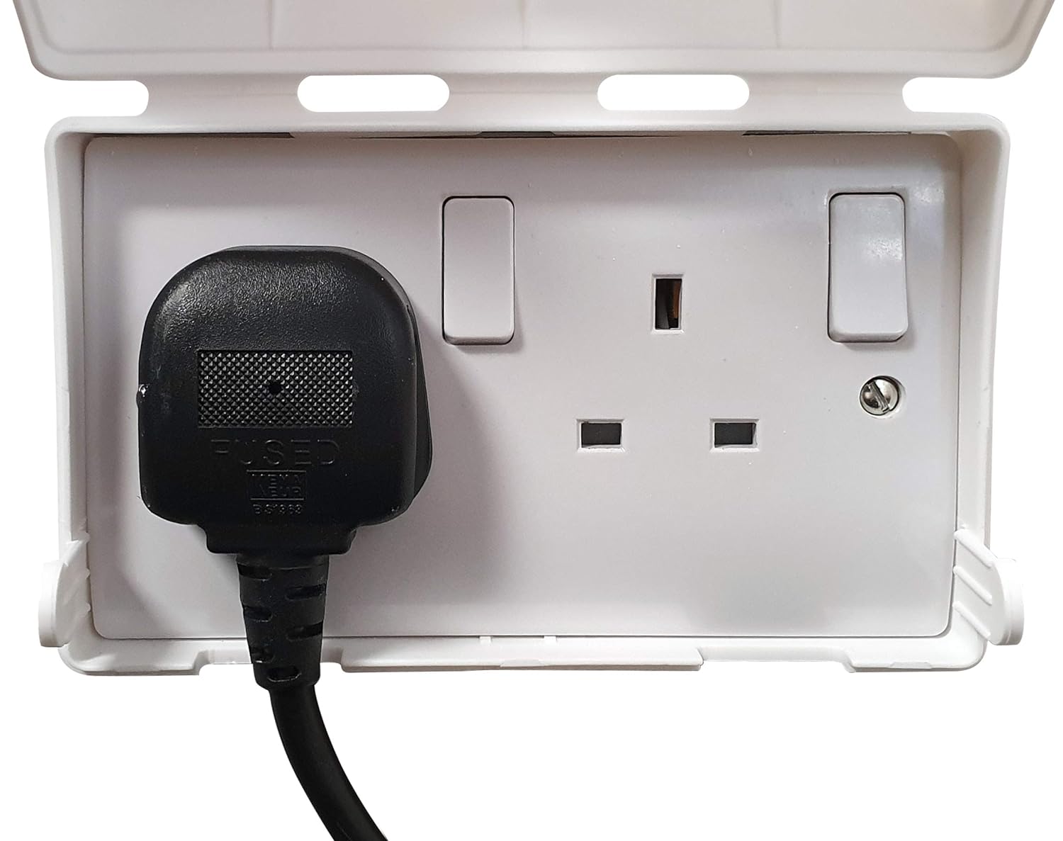

Hi,
I have a switch fuse for the gas boiler above the kitchen worktop in my house that is in a slightly vulnerable position in respect of being knocked.
Does anyone make a guarded or protected 13A switch fuse so the switch isn't knocked off?
it is usually quite a positive action to move a switch from on to off so what are you doing that means it is easy to hit the switch?
if it bothers you that much you can get covers for switches/sockets that are intended to stop kids poking things in them ie like this
Thanks, yes I've seen those but it's for a single switch fuse supplying the gas boiler.
Twice now it's been knocked off by SWMBO as she left the house to be away for a few days resulting in loss of Hive heating remote control and loss of heat to keep frost and damp at bay whilst away!
I think it's the bread bin's hinged lid that is at the correct height to push the switch off when opened! It's going to have to go....:unsure:
the link is for a single cover the pic is just one i found the single cover could cover a socket/conn unit/switch
