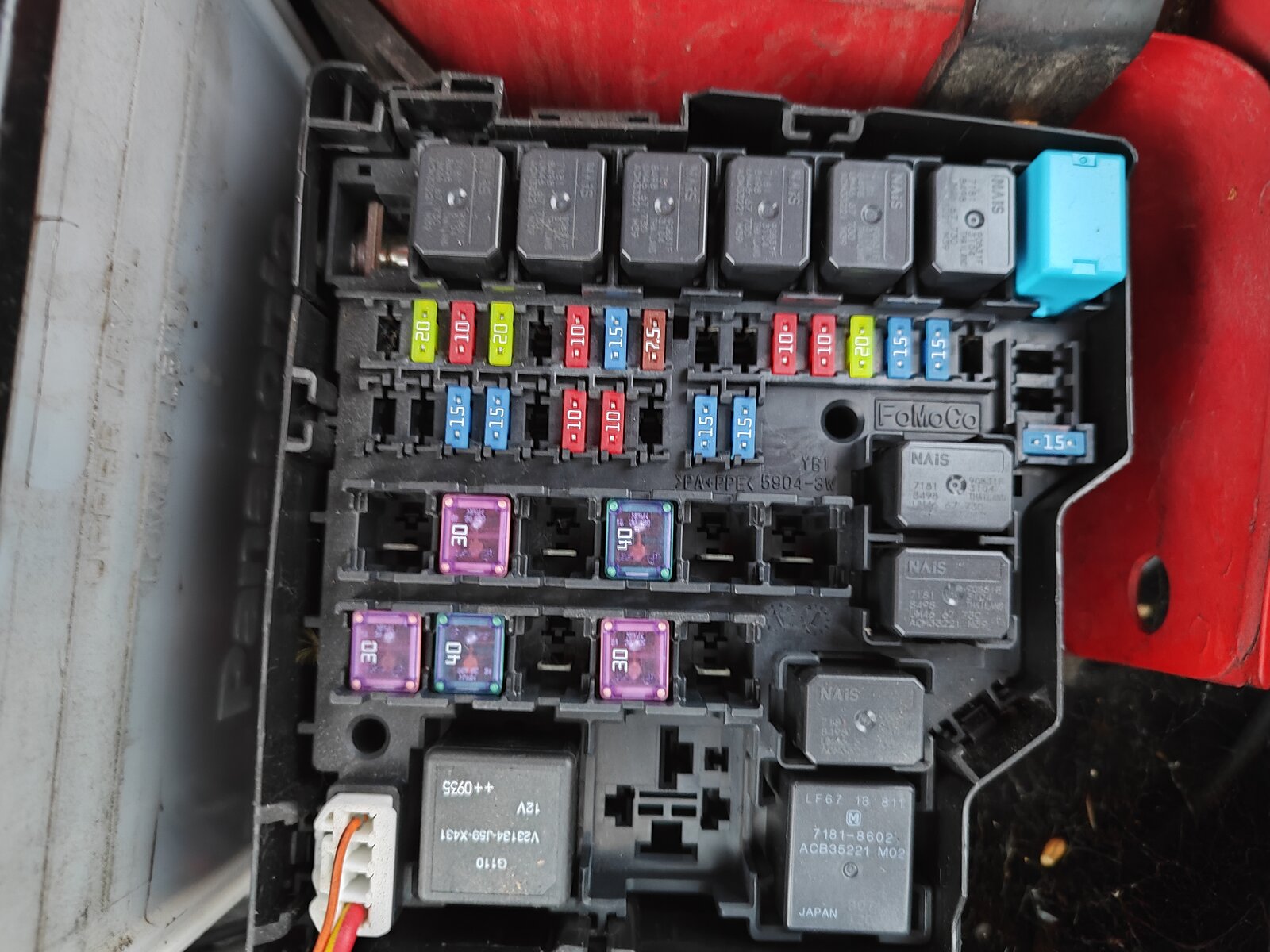

Fitted a new battery the wrong way round for a second. Realised my mistake and installed it correctly.
Now the car won't start or turn over, it just clicks when I turn the key. The lights, fan etc are working.
Is there a step-by-step process I can follow to find out what damage I've done and how to fix it?

Is there a bank of heavy duty fuses attached to, or close to the positive battery terminal?
Check these first.

Yes, there is a fuse box next to the battery. See pic.
Do I check check the small rectangular ones with a multimeter and the square purple ones by eye?
Do I need to check the black square ones at the back?

That’s only for the charging rate to be reset. That in itself shouldn't affect the starting side of things.
Think there are 2 locatiosn for fuse box, this vid shows main location under bonnet and one is in the , the vid is for left hand drive but location is similar. You should be able to pull the smaller ones out to see if any ar ebroken:

The black rectangular things are relays, and likely to be ok.
All the other things with a number are fuses so remove each one and check them visually.

Is the battery fully charged?
Your symptoms are typical of a flat battery......
