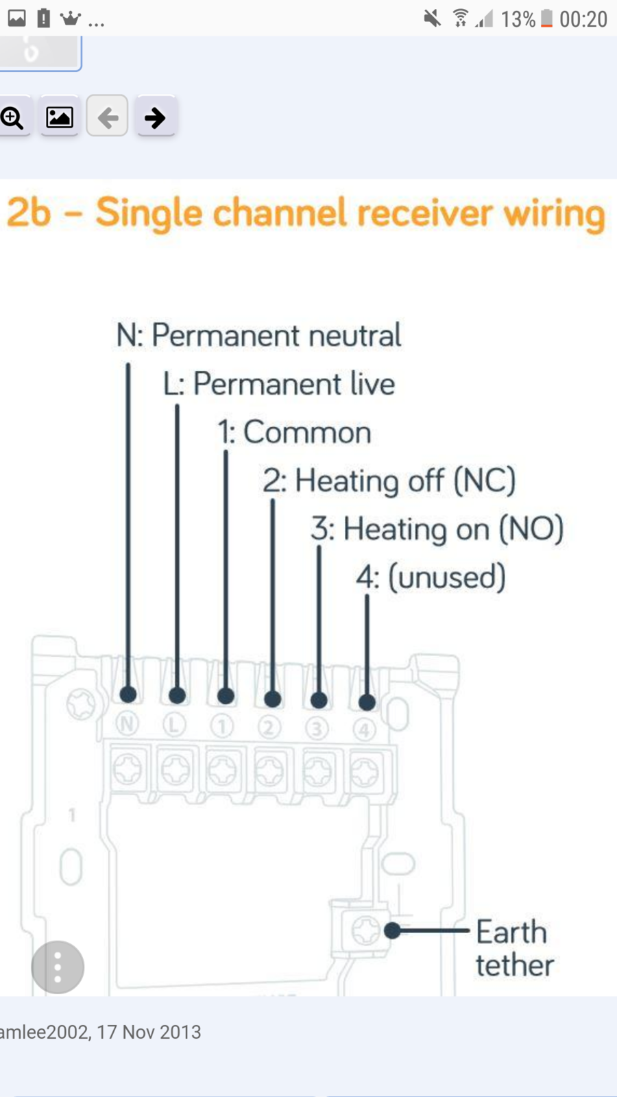

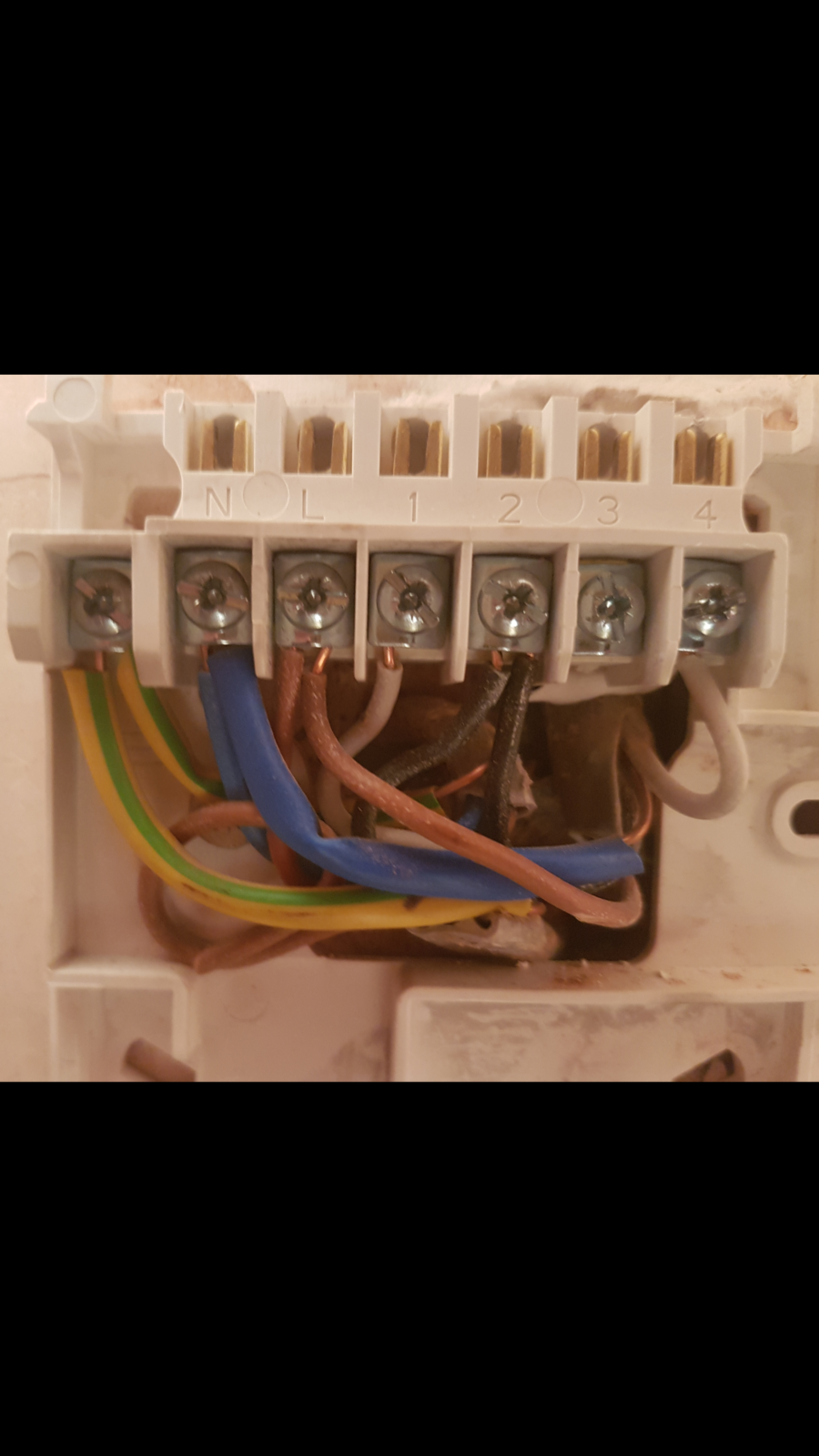

Im hoping that someone can guide me here. I mistakenly thought that installing hive would be easy enough... i know school boy error.
However could someone with my knowledge than I advise how i should match my honeywell st9100s to the single channel hive wire requirements?

Do you have a Combi boiler?
Looks like should be,
Blues to hive neutral
Browns to hive live
1 to hive 1
4 to hive 3
Blacks joined in terminal block

Thanks cofton, quick question what do you mean blacks joined in the terminal block?
