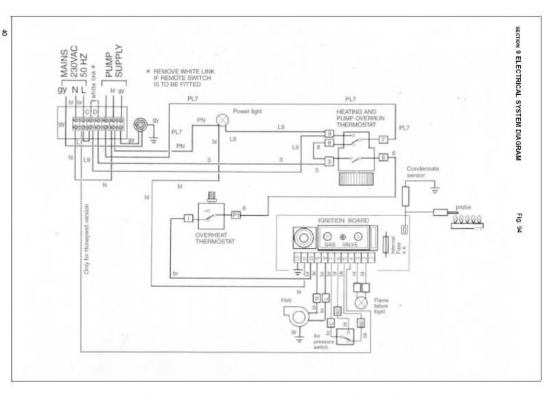

Hi,
Ive just fitted the above programmer but I am a little confused by the wiring diagram for over run boiler. The table in the instructions state that I should connect terminal 9 to LP and terminal 8 to D for a Ravenheat Primary boiler. The issue I have is that I cannot find any reference to LP od D. My Raven heat manual also seems to have no reference. Can anyone please help?
The table in the instructions state that I should connect terminal 9 to LP and terminal 8 to D for a Ravenheat Primary boiler. The issue I have is that I cannot find any reference to LP or D.
Do you have a 10 terminal wiring centre and is the pump connected to the wiring centre or is it connected directly to the boiler? 8 and 9 refer to terminals in the wiring centre and this instruction only applies if the pump is wired into the wiring centre.
LP means the pump live terminal in the boiler and D is the switched live terminal. You will also need to remove the link between the C and D terminals. See figure 94 on page 40 of the manual.

Yes I do have the 10 terminal box but the pump is located next to the boiler and is wired direct to the boiler connetions.
I have removed the c and d link as per the ravenheat instructions. Do I simply take a switched live terminal from number 8 on the terminal box and connect that to D on the boiler. With nothing else going to c?

Then you can ignore the Honeywell instructions, which assume the pump is wired to the terminal box. Wiring the pump directly to the boiler automatically enables the over-run.
I have removed the c and d link as per the Ravenheat instructions. Do I simply take a switched live terminal from number 8 on the terminal box and connect that to D on the boiler. With nothing else going to c?
Yes. Terminal C is a permanent live, but as this coming from somewhere else, via the programmer and thermostat to terminal 8, it is not needed. If you did not remove the link between C and D, your programmer would do nothing as it would be permanently bypassed.

Wired up as discussed. However, how can I tell if pump overrun is working correctly. I was led by someone else to believe that the pump should continue to run for a minute or so when the timer switches off. At the moment when I switch off the timer (programmer) the boiler and pump also simply turn off.
Further to my update below I have come across some other concerns and am now a bit confused.
