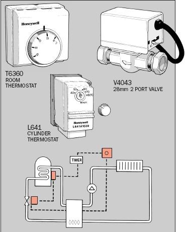

I've recently had some problems installing a new timer switch (and had help from members of this site) but after some digging have come to the conclusion that I'm not sure which Central Heating plan I have, i.e. Y, C, W etc. I have the following:-
Honeywell ST6400 timer
Honeywell v4043 zone valve
Room Stat
Cylinder stat
Ravenheat CSI Primary boiler - requires pump overrun
Pump is next to the boiler and wired direct
Store hot water in loft - indirect I believe
I would be grateful if anyone could state which plan I have so I can then source the correct wiring diagram for the Control center. Many thanks in advance.
Dan,
Also worth nothing that my V4043 has no white cable from it, if that helps
Cant see the full number (could only read 404....)on the unit but looked at Honeywells site. I have 5 wires, Orange, grey, brown, blue, green/yellow.
The pump (i believe) pumps up to the cylinder too. I have a pipe entry at top and bottom of cylinder and guess the pump pupms to hear and heats tank.
Thanks Dan and thats what I came to. Looks like my valve is only mentioned in the s plan. So a bit confused. This all started as I am trying to work out how to get pump over run working.

That is what has been bothering me. I suspect there might be another valve tucked away somewhere. The valve mentioned by the OP is not a mid position valve as they have white wires.

The valve I have is the one on the left. There is no other valve wired to the control center and I have hunted around for another but cant find. Is it possible that historically the wrong valve has been installed?
I understand that the boiler controls the over run but without any perm live there how can the pump run - I have checked with a meter?
I have been informed that my overheat switch is called as the pump turns off as the Programmer turns the heating off as the water is too warm for the boiler at that point and is not being pumped around the system after switch off.
As for the pump it does run all the time when the Programmer kicks in so must be fully pumped.
The valve I have is the one on the left. There is no other valve wired to the control center and I have hunted around for another but can't find.
Is this valve in the radiator circuit or the hot water cylinder circuit?
If it is in the radiator circuit, is there a mechanical thermostatic valve in the cylinder circuit e.g a Cyltrol?
Is the main electrical connection to the boiler, which then supplies the wiring centre; or does it go first to the wiring centre, which supplies the boiler?

But that's to be expected as your pump is wired directly to the boiler, which only works with fully pumped systems.
Well in that case your system needs a proper looking by someone who has a good understanding of heating electrics.
The pump should be wired to the boiler. The boiler needs a permanent supply and you need to figure out how the cylinder stat functions on your system.
Not sure which circuit the valve is on as I've been concentrating on electrics - how do I know?
The main electric connection is to the Pragrammer not boiler, hence no PL there when Prog is off,
