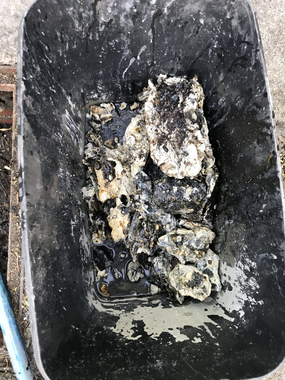

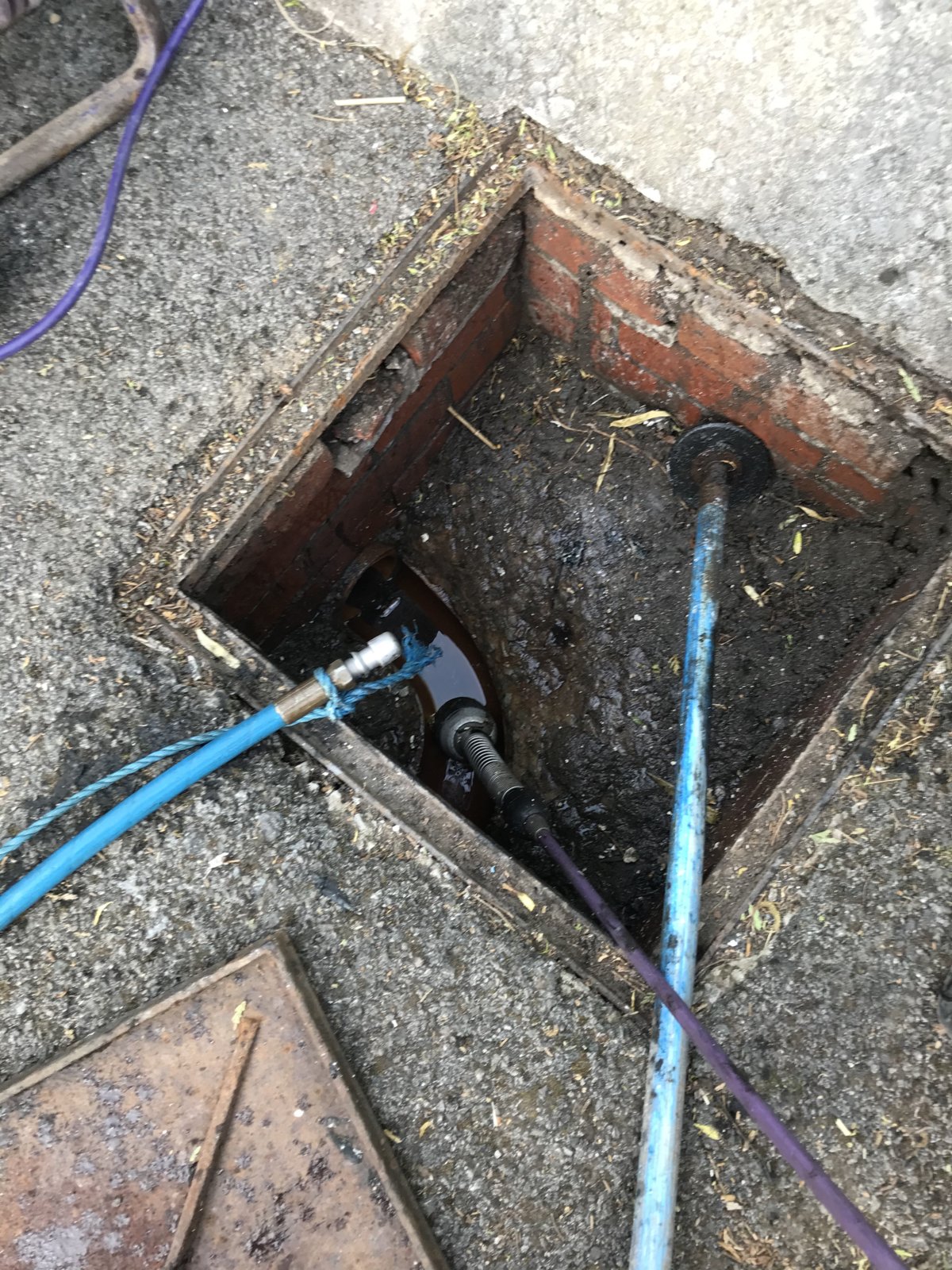

If there is a manhole downstream a decent drain guy could use a rope to pull his jetter up the junction to the gully. I did one a couple of weeks ago and pulled out this lot:
