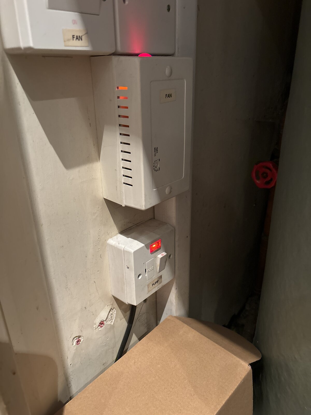

We have recently moved to a flat that is run on electricity. We had a bit of a nasty shock with our last bill and are looking at ways to reduce our usage. We definitely had the heating on a bit more this month so that contributes we know but we are wondering if we can be more efficient with our immersion heater and how we use it. To be honest I don’t have a clue about these things and, having done some research am still not really any wiser. Any tips on how to set ours up? Also, why is there a panel heater and an immersion heater switch? Everything is switched on at the moment but I’m sure there is some kind of thermostat but haven’t worked out how it is set - hot water seems to run out quicker in the morning than the evening so I’m guessing it goes off over night? If I wanted to turn it off manually while I figure out the thermostat - do I turn off all switches? E.g., immersion, panel and pump?! Or just one? Thanks in advance

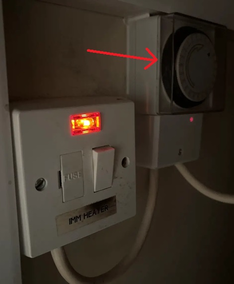

Much will depend which electricity tariff you are on. If you use electricity as your main heating you should be on a tariff that offers you off-peak times when the electricity is much cheaper. Economy 7 or Economy 10 for example. Your electricity bill or supplier will be able to tell you. Then it's just a matter of setting the immersion heater timeswitch below to only turn the immersion heater 'on' during the off-peak times. The main IMM SWITCH switch should be left permanently 'on' otherwise the clock on the timeswitch will stop. However there may be a possible exception described below*

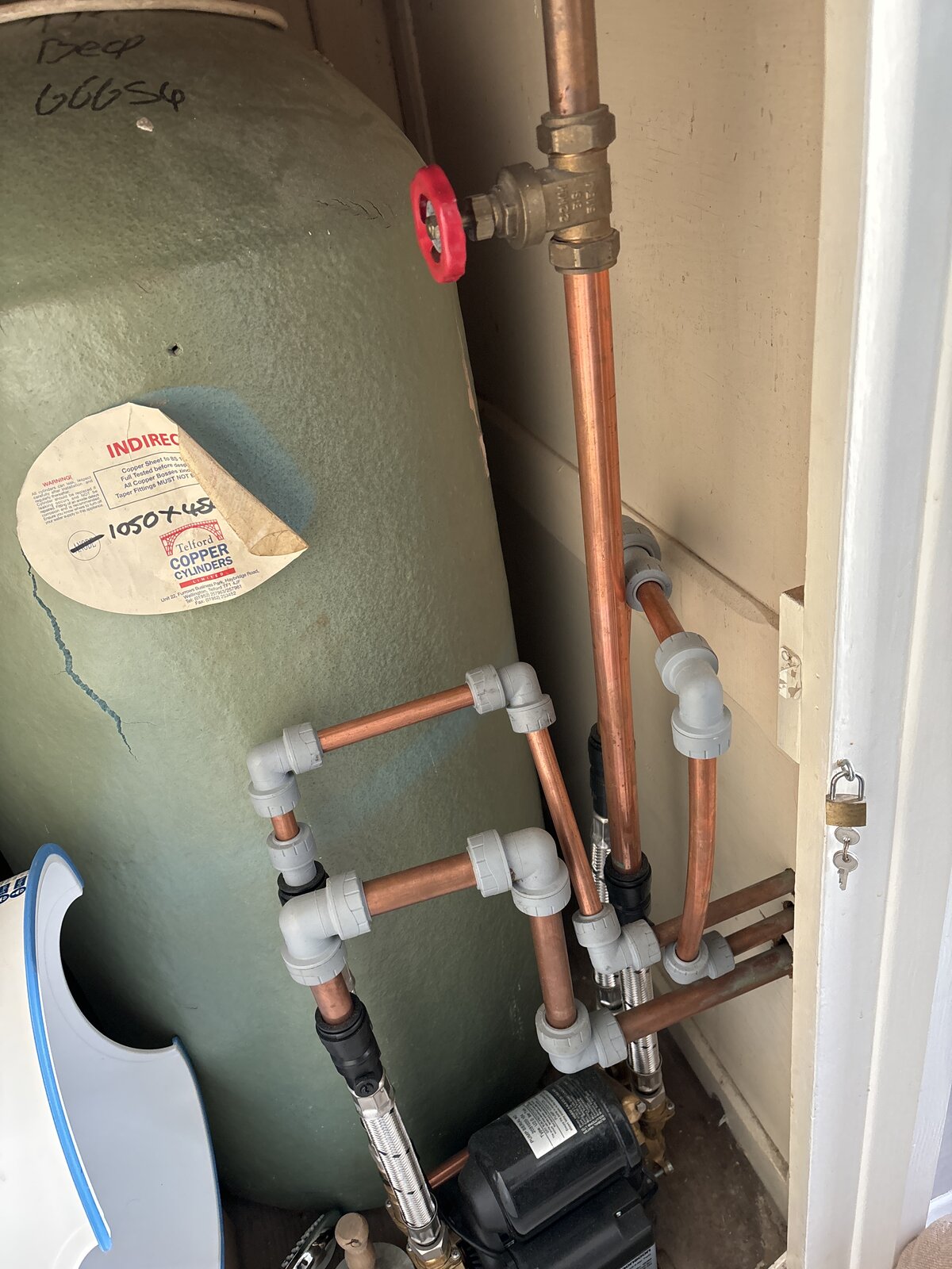

Send a picture of your cylinder and pipe work

Insulation on the pipes will help. But looking at that cylinder it appears not to be vented.
Can you send a picture of the whole thing

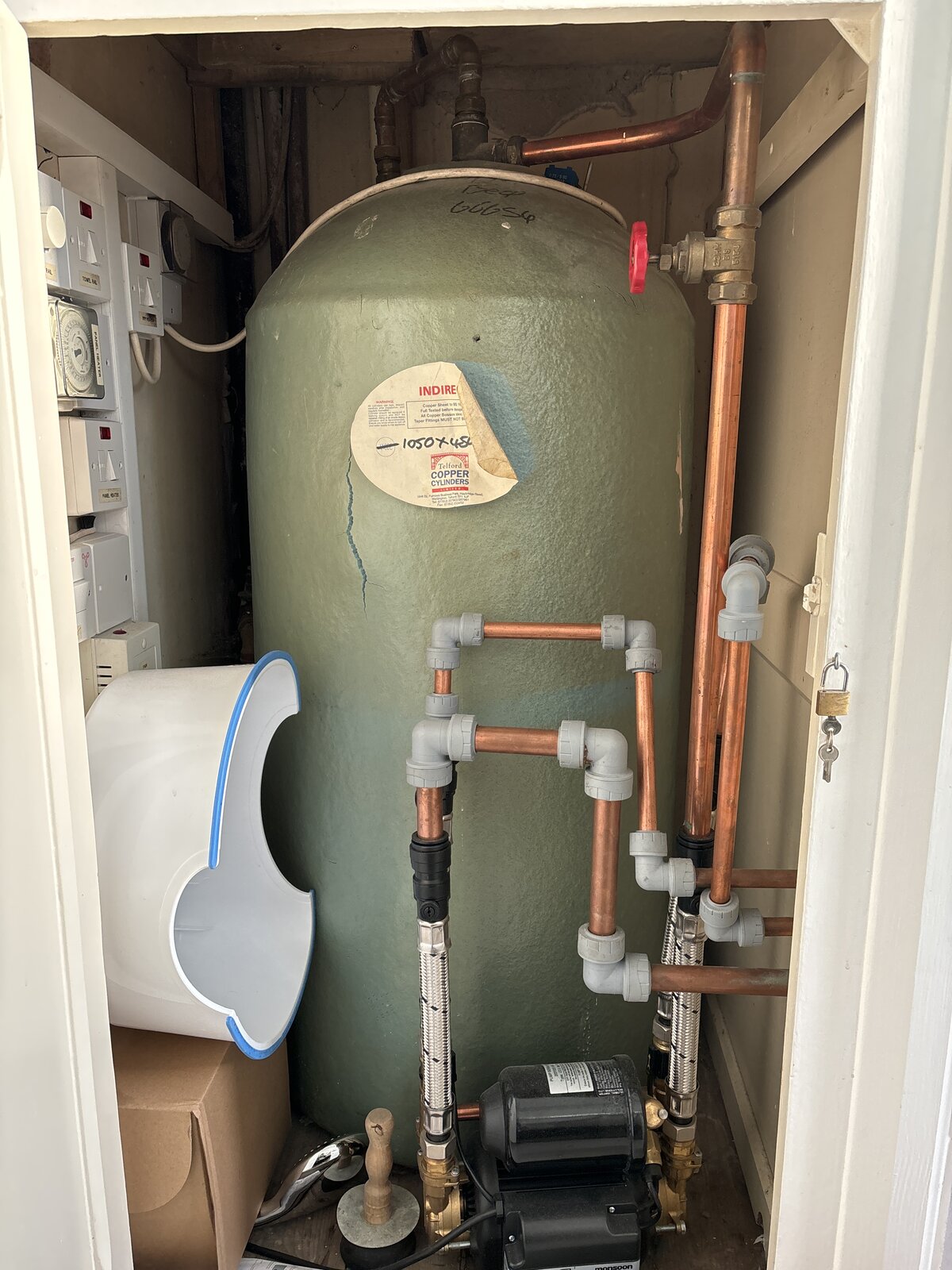

Is that better? Cheers

There are a few things I notice from your photo and the first is particularly worrying.
1. The casing appears to be missing from the immersion heater which means live wires are exposed. :eek:
2. As @Bod ... there doesn't seem to be a vent. That's nothing to do with the electricity consumption, more of a plumbing issue to do with venting air bubbles from the water before it gets to the taps.
3.
It's important that the hot water cylinder and the hot water pipe leaving the top of the cylinder are well insulated. That way once the water inside is hot it will stay hot.
Cylinder insulation looks OK but no insulation on the hot pipes :rolleyes:
