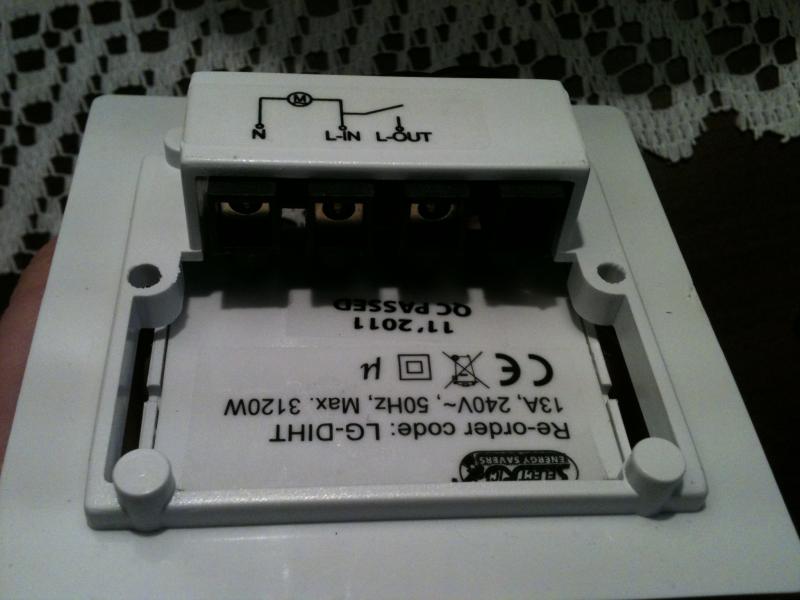

Hi all,
Finally I have a chance to write. Life has been very hectic!

manufactures instruction says:
- contact rating 16A, 240V, mains frequency 50hz, connections 2.5mm.
- "check that the mains voltage and frequency correspond to the rating plate (on back of timer)" -- 13A, 240V, 50hz, 3120W
- Do not overload. Refer to the Ampere rating on the rating plate.
These are the only installation instructions given. Nothing given about the wiring or terminals.
The immersion is on its own circuit in my house. It has a 16amp switch in the electric box.

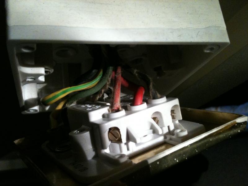

Can I take it that this timer does not require connecting to a fuse before hand? And, the instructions kindly given from Riveralt detail what to do with the existing wires which are connected into the original switch's fuse:
Riveralt wrote:
There will be a supply cable that comes to the switch/fcu from the consumer unit - this will contain a red/black and earth cable.
There will be a load cable that goes from the switch to the immersion heater - this will contain a red/black and earth cable.
So the Red supply goes into L in.
The red load goes into the L out.
The supply and load black cables together go into the N.
The earths need to be sleeved and connected together.
Sunday I will finally get an opportunity to look at the setup in detail.
Many thanks to all who have given thoughts to this.
original switch:
timer switch:
It would appear that all is well as the instructions state the contacts are rated at 16A.
It is confusing to have a different figure printed on the casing.
However you need to leave the switch in place and wire the timer between the switch and immersion.
The switch will be useful to switch off should anything go wrong or when you go on holiday.
Are you suggesting to leave the switch in place because this contains a fuse, to come before the timer? Or just to turn on and off all the power to the timer if necessary?
I ask because the timer has an on/off override button. Also it would be a messy install compared with a straight swap. I had presumed the old switch could come off the switch box external to the heater cupboard and be replaced with the timer switch. I think riveralt's instructions were for this too.
Not because it contains a fuse - just use a 20A DP switch (unfused).
Yes, to isolate the timer and the immersion.
I feel confident in saying that if you look at any other house you will not find one which does not have a switch.
That is to turn it on/off without altering the time settings.
It is not good enough to isolate in the event of a fault.
Even the MCB in the CU will not disconnect the neutral.

The circuit should be - all in 2.5mm² cable.
16A mcb >>> 20A DP switch >>> 16A timer >>> immersion.
