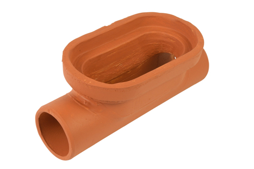

Inspection cover access
Here's another one with the cover off to help give some perspective...
So why is it dry now?
Thats where it gets a little bit interesting. The sewer actually has two routes which forms a square. The entry from the house always prefers the other route and they both join at one of those small manholes then go off to a septic tank.

Interesting the square design of the pipework.
I have not seen those oval covers before.
How do they look from the side? Two pics from side and end?
I am wondering what tool you could make to lift them from above.
Tony
They are about an inch thick and have a dinosaur like ridge on the back, but no holes so you can't hook them. I'd need to go down the hole again to remove one for pics and i've been frowned upon for doing that :)

Hugh, do you have any photo of the cover?
