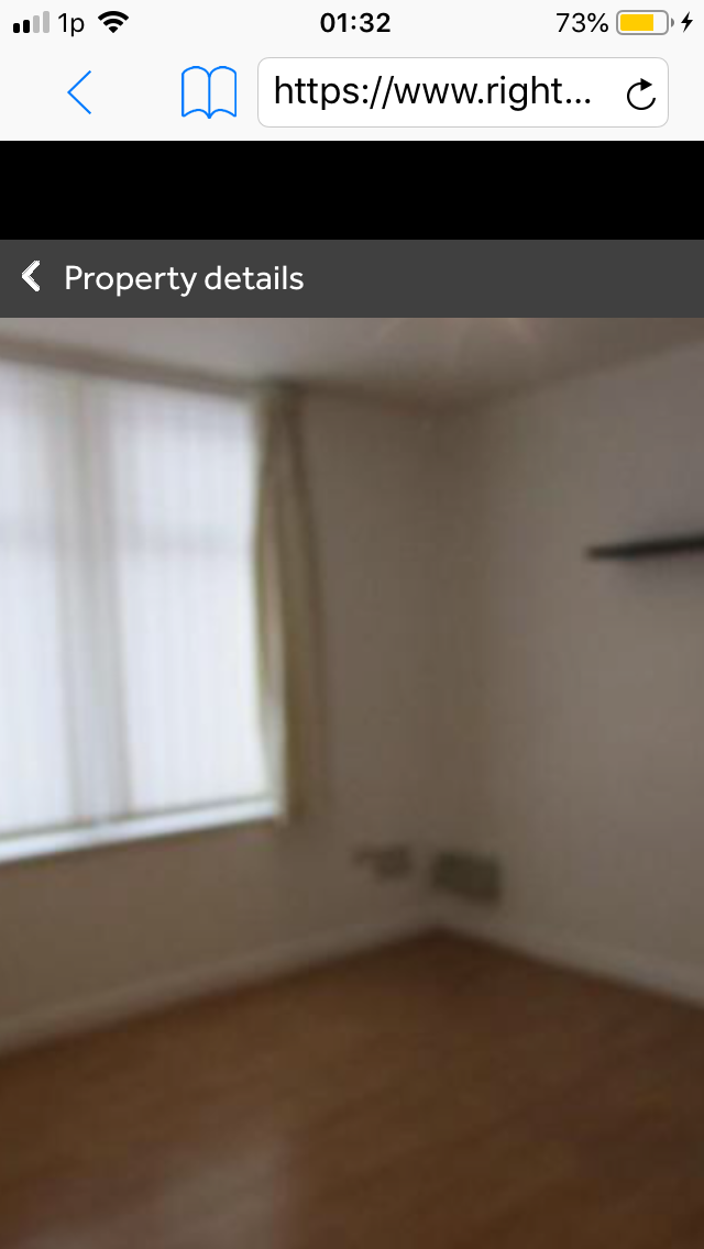

Hi, I’ve got a ground floor flat conversion in a 1900 ish house.
There are 3 air vents above floor level about 2 feet up the wall. Those areas seem a bit cooler obviously and maybe causing condensation ?
(There was also a higher level one near the ceiling)
You can feel a bit of a draft even when the inner plastic vent cover is shut.
There is also an air vent in the chimney breast, chimney has been capped.
There is only electric heating and I’m thinking these vents could be a throwback from when it had some gas ?
Or could it be needed maybe to vent to wall cavity (if it has one!)

Some photos would help.

Photos will help, inside and out. Stand back and pic the whole wall.
Don’t know if it’s any help but these are the pics I already have, not too clear but the block to left of consumer unit is vent in lounge area.
Other one is different one to rear wall to right of heater.
I’ll get external pics too thanks

The one under the window makes me feel it was to combat damp, or possibly if there was once a gas heater there.
I can't see the other one enough.
Is there a ventilated void under your floor, or is it concrete?
If you have a gas fire they can also be there to aid complete combustion. I don’t know the exact reasons, just that they’re needed. The one in the chimney could be to encourage airflow in the chimney breast to prevent damp
