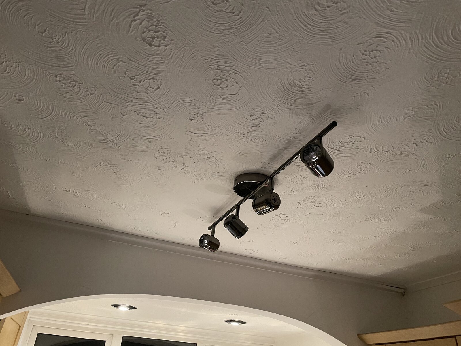

Any idea where I’ve gone wrong with my kitchen lighting?
The main light fixture (spotlight bar) is VERY dim as you can see from the picture. All the light comes from the 2 down lights (it’s like they are stealing all the power). The spotlight bar flickers a bit brighter when switched off.
Background - whole house was re-wired and the spotlight bar was fitted by the electrician. The two spot lights where old school bulky down lights so i swapped them with an LED conversion kit from screwfix.
I’m guessing I’ve missed something simple?
You've probably ended up with the downlights in series with the spotlight bar, post pictures of how you have connected them
Those spotlights are never a good idea in a kitchen.
They create shadows and only illuminate certain spots.
Disconnect that fitting and try a simple fitting with a 15w+ led bulb.
Then see if it makes any difference.
If so, throw the spotlights away and buy a kitchen light fitting of high wattage (20W led is plenty)
