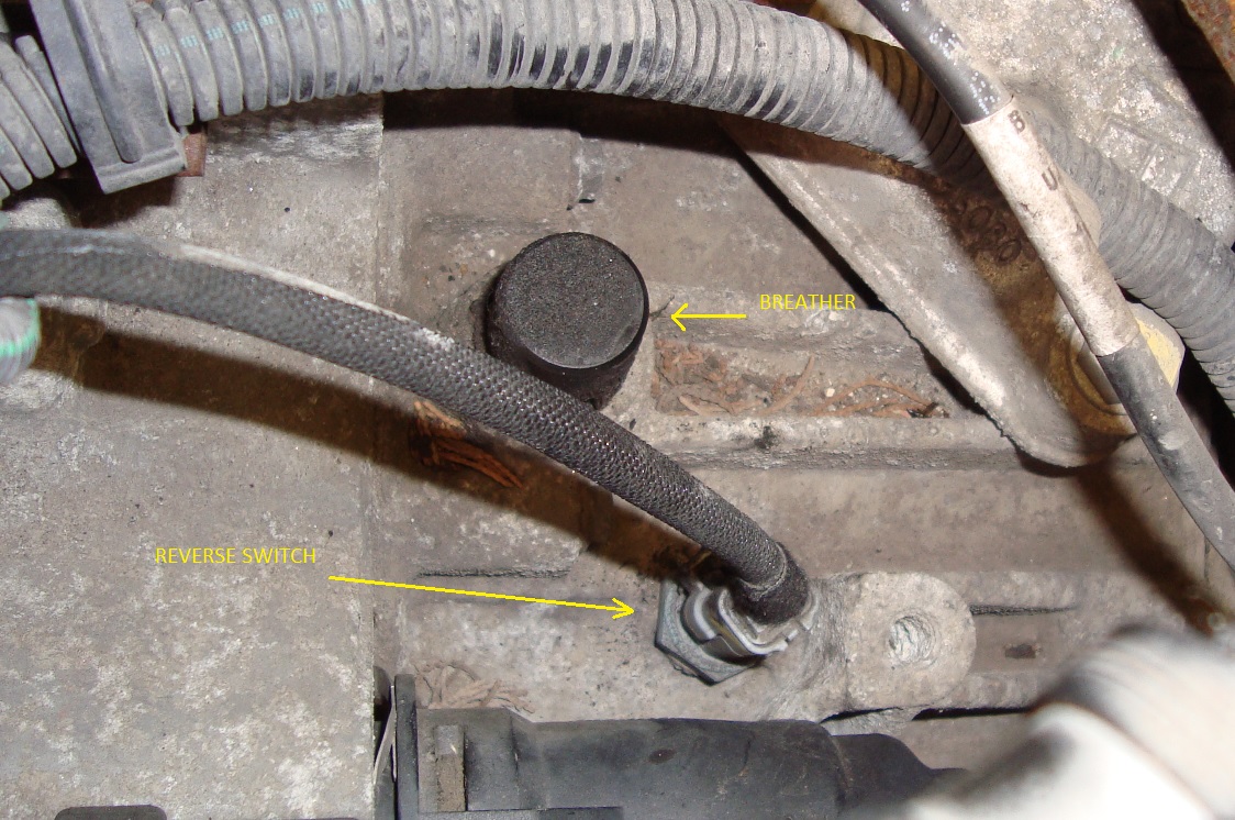

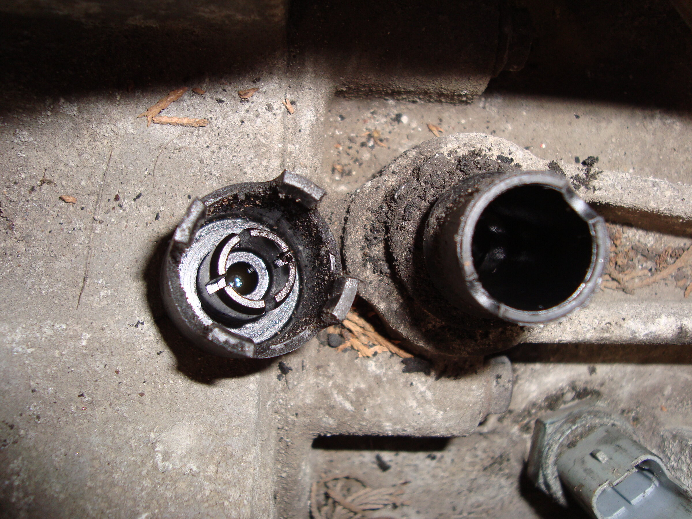

However, I think I have found how oil can go into the box. This may be useful to owners of late 90s/early 2000s 2.0 Jtd engines and 2.0 HDI engines of a similar vintage on other vehicles (Dispatch, Expert, etc, etc.). If the air filter box is removed there is a black plastic breather with a cap that pulls off easily. Almost next to it is the reverse light switch. I'm opting to use the breather, as I have visions of a reverse switch that's been in for 16 years being tight and shearing off. So, it's funnel and length of PVC pipe and job's a good-un. Thanks for your reply, Mottie.

Wasn't too bad in the end, John. Changed it today. The old oil that came out was approx 200ml less than the 1.85 litre that is supposed to be in there. Old oil looked a bit murky - certainly a lot darker than the fresh Millers TRX that went in through the breather hole on top of gearbox. Length of tube, small funnel and patience. Relieved to see very little in the way of metal particles on the magnetic part of drain plug.
