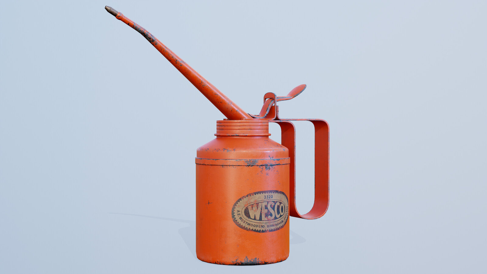

Anyone remember that green engine oil - Duckhams 20W50?
I still have some in my old dad's red oil can
one of these, obv.
