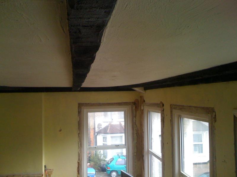

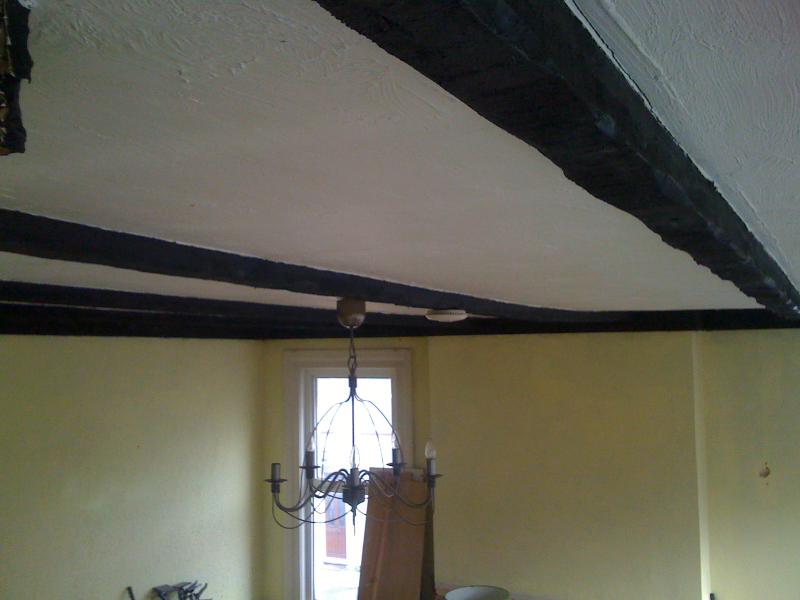

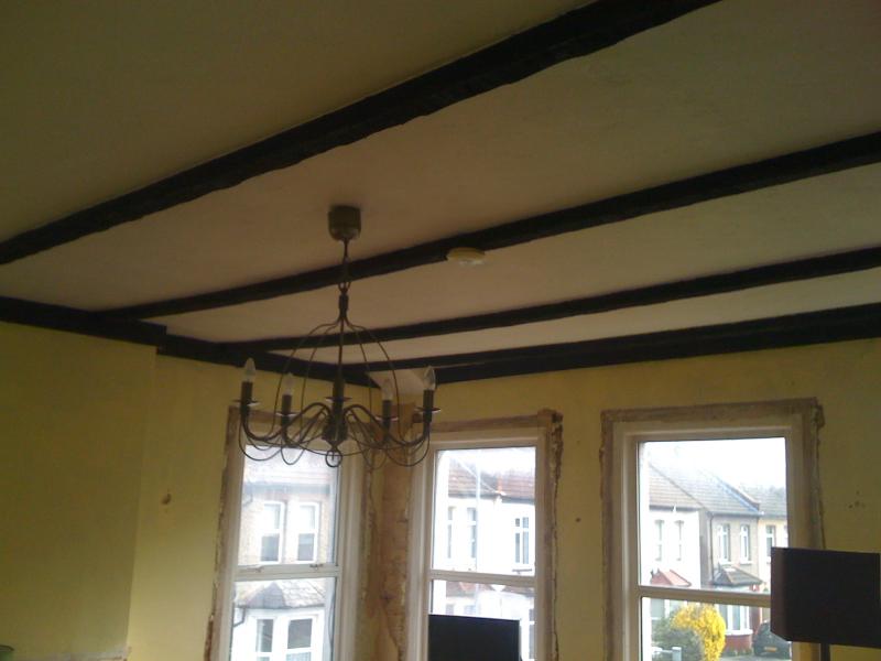

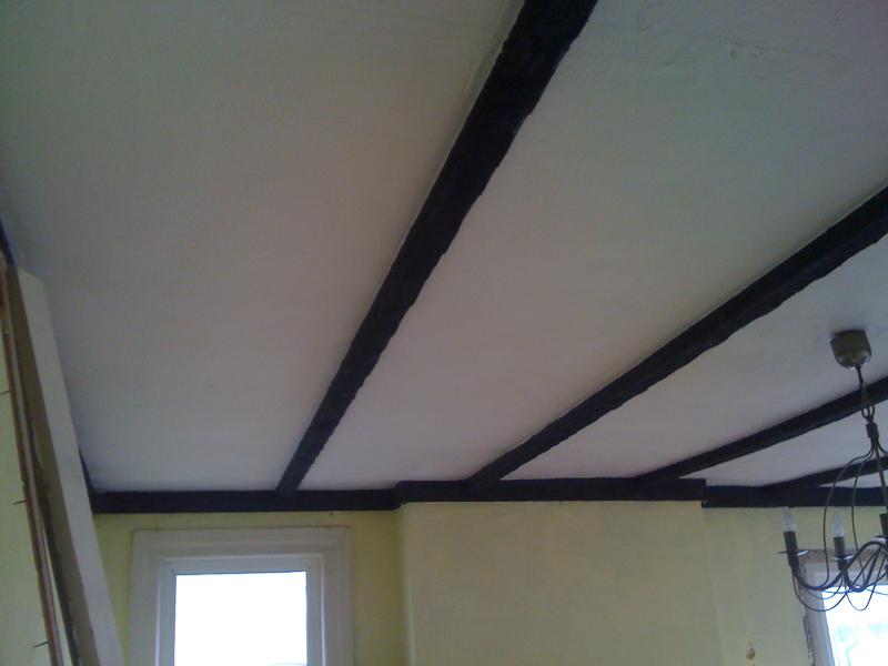

Are the black beams decorative (fixed to the ceiling) or structural (supporting the floor above)?
In which direction(s) are the ceiling bowing? (parallel with beams or at right angles to beams, or both?)
Hi they are decorative, I have checked and they are screwed through to the floor rafters. the rafters run at right angles to the beams. But I think they are helping to support the plasterboard above as its boing inbetween them
The black beams could have been added to help stop the lathe and plaster separating from the ceiling and if this is the case removing them may mean the whole ceiling does need to come down.
To make the ceiling flat you will need to fit a new suspended ceiling (cannot use old joists they will be warped) and you will lose the decorative cornice and ceiling height will drop by the thickness of the new ceiling (frame+board+skim). To do this, remove the cornice and fit a new timber frame just below the old ceiling height per previous replies (then sheet and plaster). Removing the old ceiling will only get you a little extra ceiling height (about 20-30mm if lathe and plaster), if you leave it in it will help with thermal and acoustic insulation, plus a lot less mess. You could try removing one of the black beams and seeing if the ceiling becomes less solid - the beams could always be left in but you would lose another few mm ceiling height (the depth of the beams)
You can install cabling etc after the new frame is up before it is sheeted.
Top of wall will need repaired if the new ceiling height is higher than the bottom of the old cornice.
Good luck.
Thanks for the replies.
The ceiling bows along the direction of the black beams, but also bows in the other direction in between them. I think Plasterboard has been fitted over lath and plaster with nails rather than dry wall screws, and then the beams fitted. These are nailed into the joists. As screws would have pulled it up a bit. But I think they obviously help support the plasterboard in someway.
I was going to batton out with 2.5" deep wood in the same direction as the beams as this is deeper than the black beams. Thus not havingto remove the black beams. I was going to fix the new battons to the joists with 100mm Screws. Why would the joists be bowed? I was going to place the battons 2ft apart. Surley screwing the new battons in will pull the existing ceiling up a bit? I can then pack the new battons where needed to get a level on them. This would then give me a flat surface to screw the new plasterboard to. I understand this has to be placed in an alternating pattern.
