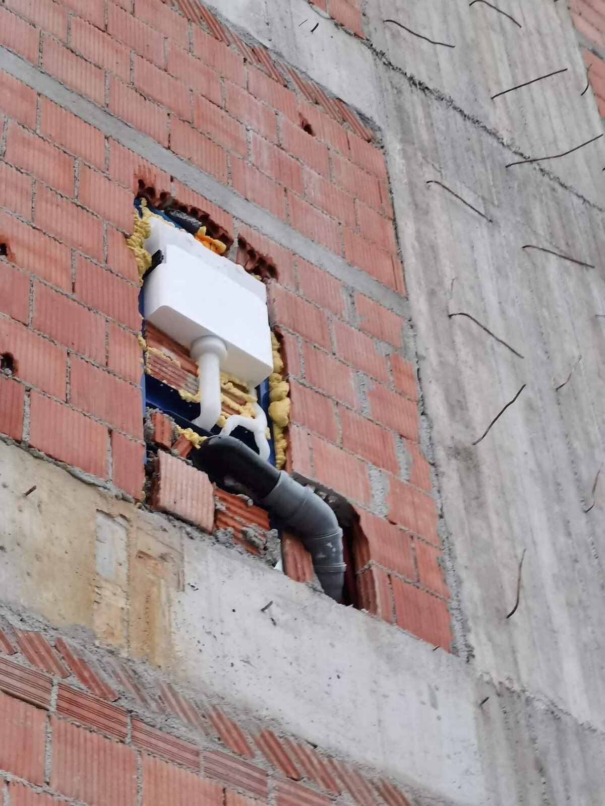

Absolutely, with the requirement for aesthetics cistern could be concealed in a suitable position and only the pan need be visible. Although some seem to be taking concealed cisterns to the extreme...
