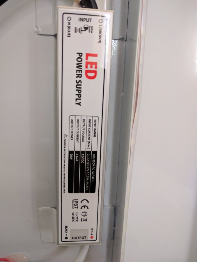

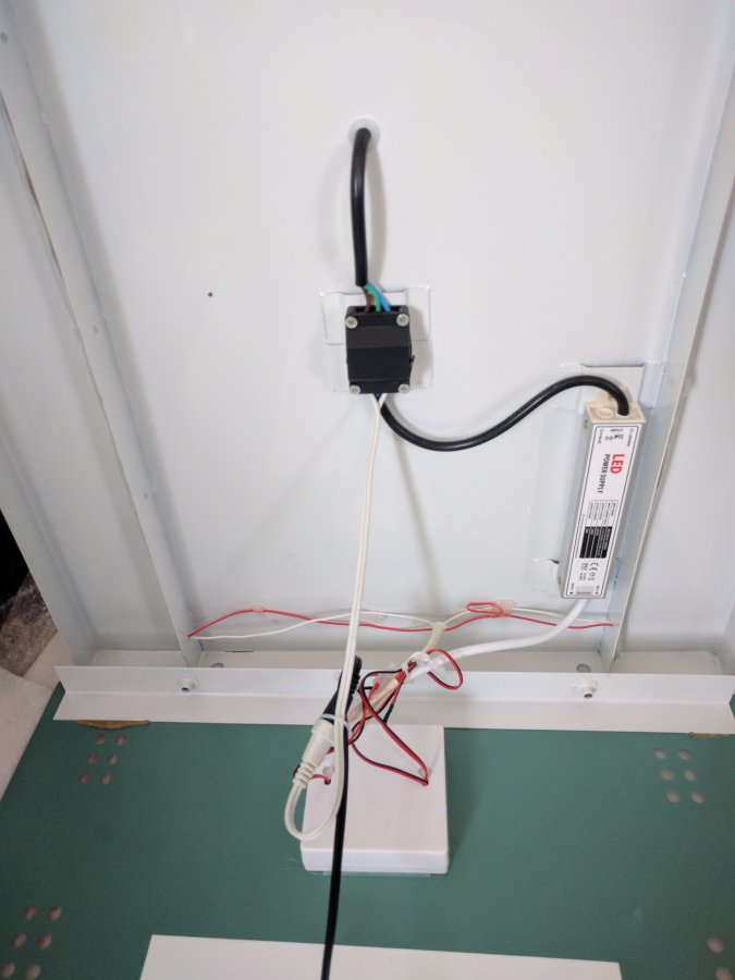

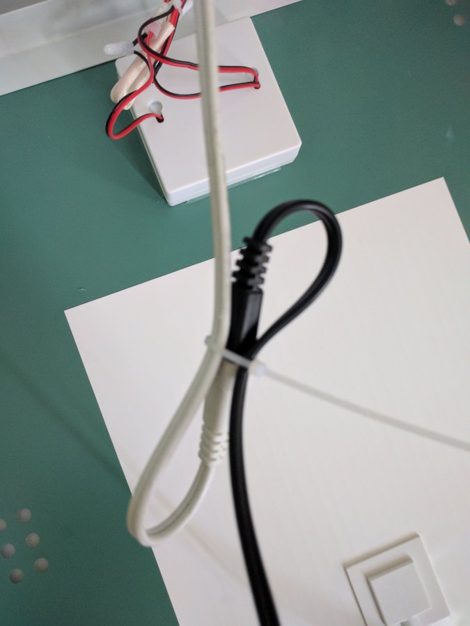

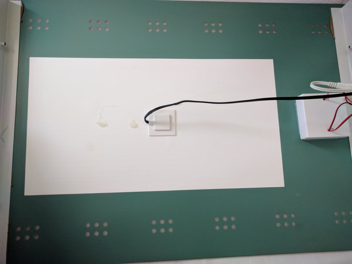

Hi all, 4 screws and managed to get it open here are some pics. As you can see the feed splits so should be able to do the pull switch method. The white box is for the clock and led lighting touch control.
So you need to put the switch in the white cable that comes from the heating pad. It may be convenient to have it where the white cable and the black join together.
Your problem with a pull switch will be that you will not know if you have it switched on, or off.
One thing I do not understand. How do you turn the mirror LED lights on and off?
The lights are controlled by the white box with red wires sticking out. They are activated by a touchpad on the front of the mirror which also has the time on it.
Yes the the black/white cable join looks to be the most convenient way to put the switch in. The only way I'll know it's on/off is to touch the mirror so will have to live with a few smudges I'll guess, unless there's another way.
