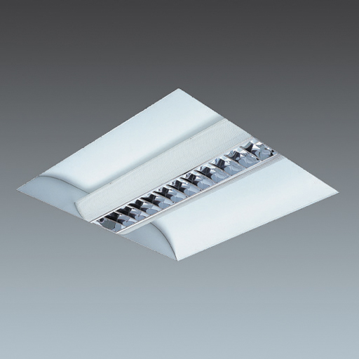

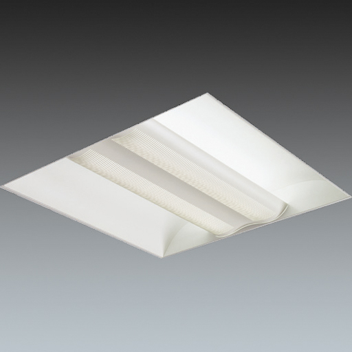

The modern ones use reflected light.
This is where you cant actually see the tube at all, it shines light at the fitting and reflects it downwards.
Its hard to explain. I'll find a link to a fitting.
They are available in a few different configurations including ones with an integral emergency pack.
This one combines reflected light with a standard downwards light. You can get some super efficient fittings these days too.
