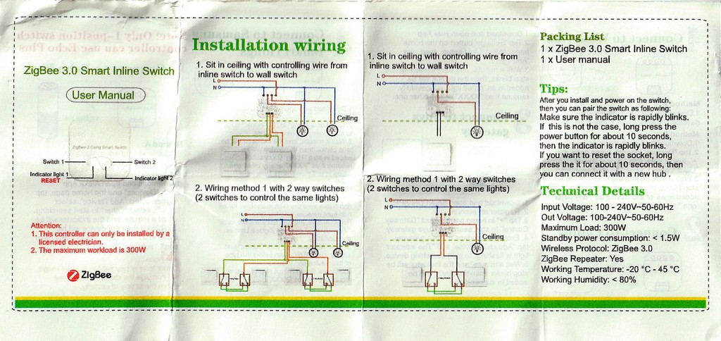

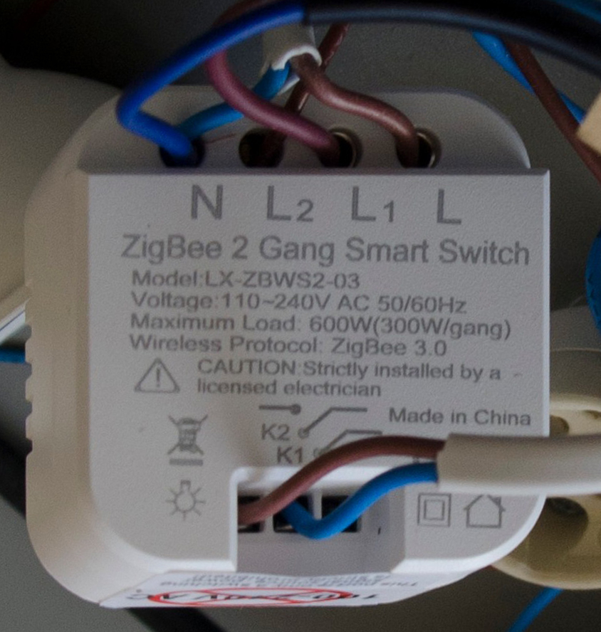

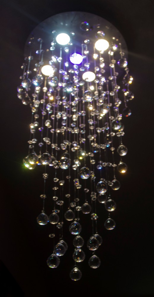

Although it feels as if one is switching the switch on/off, behind the facade there is a push button, well in fact three, and a pair of AAA batteries. That's for main door. Other lamps have other methods, including a relay which allows standard switches to be used, DSC_6061r.jpgLanding-light-relay-instructions1.jpgLanding-light-relay-instructions2.jpgI don't expect you have anything like that, but some day I will die and some one will buy the house from my children, can you imagine trying to work out what is going on with a relay like that, the bottom two wires go to the switch and are extra low voltage, we never use the switch, always use voice commands to google Nest Mini's, in hind sight should have not fitted the relay in the lamp, DSC_6799.jpg that lamp is not going to be easy to open to gain access to the relay inside, hind sight and hind sight is easy, should have just used 5 smart GU10 bulbs, but wanted the switches to work with the app, and as fitted the app is just like the intermediate switch.
As said unlikely you have that system, but some day some one is going to buy a house with smart devices and they may not realise they even have them.
