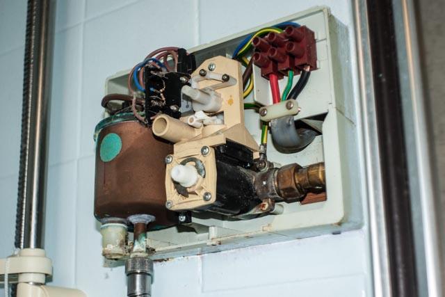

Our ancient Mira 8 electric shower has developed a fault...
The shower itself is working fine, and does the job, but today I noticed it was starting to leak/drip from the control box.
Doesn't happen when the water is off, but begins shortly after it is turned on, whether the power is on or not.
I've removed the front panel and found the leak to be coming from the front of the water supply control, at the join between the beige coloured part (with four screwheads) to the black portion where the water supply enters the unit
Is this just a washer issue that I will be able to sort, or am I looking at a new shower...???
[/img]
Might be able to repair it with o ring, overhaul. But you be better off with a nice new shower as it look old.
Have a look in showerdoc.com
Daniel.
As said you can try yourself replacing the o ring.
But as for spares they are obsolete for this model, this model ran from 88 to 92.
Thanks guys...
I've just dismantled the valve and both O-rings are flattended and sticky...obviously perished.
Shame I can't obtain replacements as the shower itself still functions...:(
