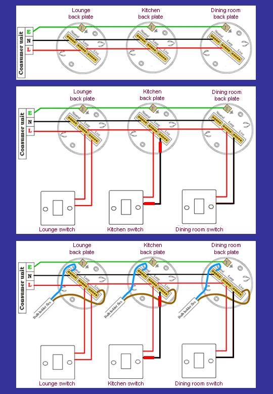

Perhaps look at this wiring diagram, which is what @EFLImpudence might have been on about. Perhaps you’re testing between live and switched live. Perhaps you’re concentrating on 2 wires, but have no understanding of how they operate.
What do you suggest that I call them if not live & neutral?
Live and SWITCHED LIVE
The voltage between then will be ZERO when the switch is ON but both of them will be LIVE .both will be 230 VOLT above EARTH. DANGEROUS
The voltage between then will be 230 VOLTS when the switch is OFF one of them will be LIVE 230 VOLT above EARTH. DANGEROUS
The other one will have path to NEUTRAL via the lamp but it is NOT Neutral

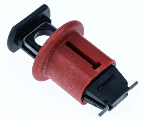

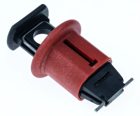

Yes I do use one of these upload_2021-4-8_17-8-56.png to lock of the RCBO which only locks off the line, however I know my home is on a TN supply, and I am aware there may be voltage on the neutral so I work with care, which includes a neon screwdriver, I have had power return when working on an installation and also a nasty belt where another electrician was using an insulation tester on the same system, good job foreman was a good runner, had I caught him I may have been sacked.
Other electrician could not work out the odd insulation resistance readings he was getting!

I have checked and I do get zero when the switch is on & 230V when the switch is off.
So previously, either I was testing with the switch on and did not notice or I was not making contact. Thanks for sorting out my confusion.

Looking at the third part of the diagram here
that connection is made at the bulb and the switch opens / closes a gap in the live wire.
I don't see any physical reason that there could not be, say, two live wires going to the bulb with live & neutral going to the switch.
